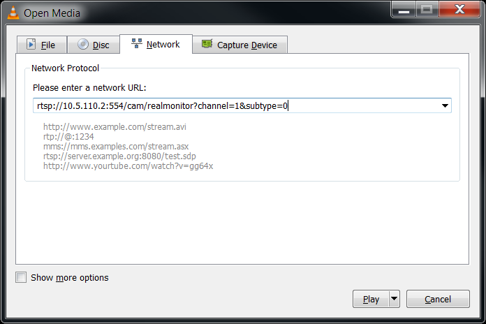

From the Media menu select “Open Network Stream” (Ctrl+N). In the text field enter the URL of the video/audio stream from the device.
You might get a prompt to enter authorization credentials. Make sure to use the same credentials also when adding the device in the Management Application.
