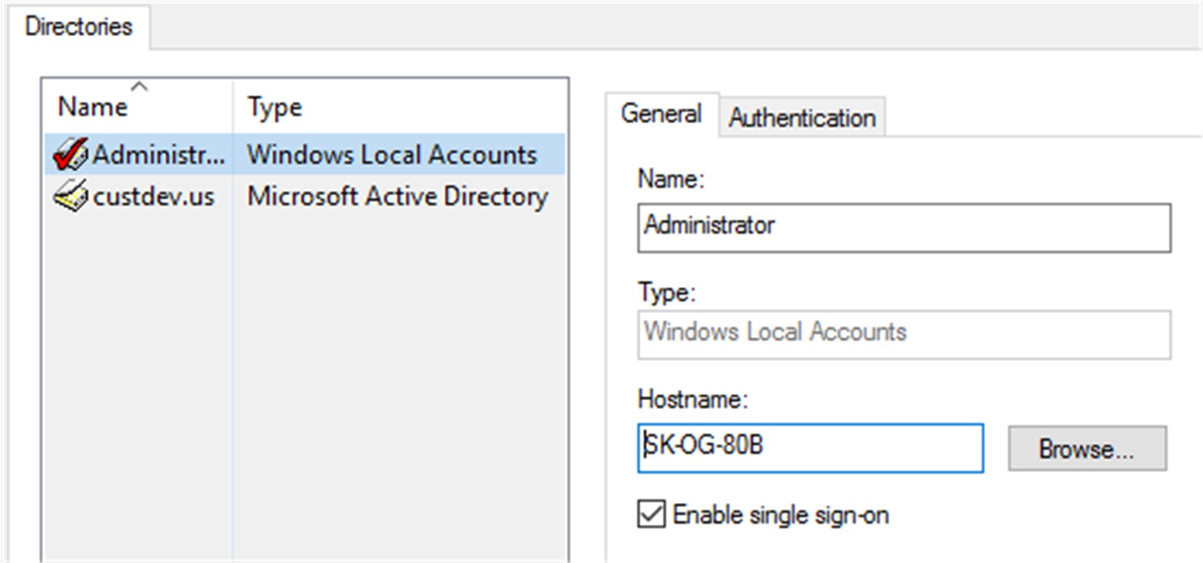

Windows Local Account |

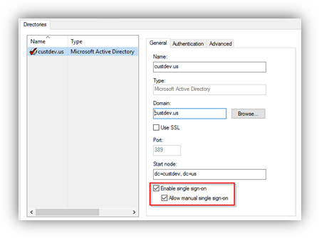

Domain User Account |
For Windows Local Account support, the single sign-on account MUST be a “Windows Local Account”. |
For Domain User Account support, the single sign-on account MUST “Allow manual single sign-on” as shown below. |
WARNING---If you are creating a Directory of a type other than “Windows Local Accounts” (e.g. LDAP, Active Directory), ensure that the SSO user is a member of the Local Administrators group.---WARNING
