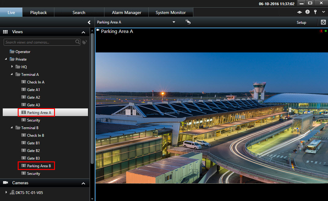

Searching for views and cameras (explained)
If you have a large or complex hierarchy of view groups, the search function makes navigation easier and allows you to search for views, cameras - including camera characteristics (see also Camera characteristics) - and keywords across the hierarchy. You can find an overview of common keywords if you click next to the search field.
As you enter the search words, matching results for views and cameras are displayed. When you select one or more of the matching cameras, the cameras appear in a temporary view that is optimized for the number of cameras you select.
To view a single camera in a 1:1 view, click the search result in the Cameras section.
To view the first 25 cameras in a view, click the search result in the Views section. You can also select cameras manually if you press either Ctrl or Shift while clicking the cameras. Press Enter to view the cameras.

- In the Views pane, right-click the relevant view.
- Click Send view to and then specify how you want your view to display.
