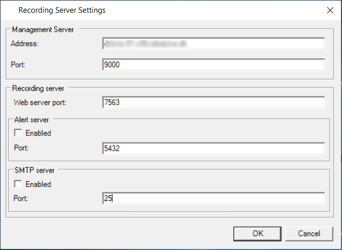

  3. Right-click the Recording Server icon again and select Change Settings.
    The Recording Server Settings window appears.
  4. Verify or change, for example, the following settings:
    • Management server: Address: Specify the IP address or host name of the management server to which the recording server should be connected.
    • Management server: Port: Specify the port number to be used when communicating with the management server. You can change this if required, but the port number must always match the port number set up on the management server. See Ports used by the system.
    • Recording server: Web server port: Specify the port number to be used when communicating with the recording server's web server. See Ports used by the system.
    • Recording server: Alert server port: Enable and specify the port number to be used when communicating with the recording server's alert server, which listens for event messages from devices. See Ports used by the system.
    • SMTP server: Port: Enable and specify the port number to be used when communicating with the recording server's Simple Mail Transfer Protocol (SMTP) service. See Ports used by the system.
