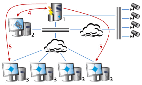

Based on functionality handled in the event server, the alarms feature provides central overview, control and scalability of alarms in any number of installations (including any other XProtect systems) throughout your organization. You can configure it to generate alarms based on either:
- Internal system related events
For example, motion, server responding/not responding, archiving problems, lack of disk space and more.
- External integrated events
This group can consist of several types of external events:
- Analytics events
Typically data received from an external third-party video content analysis (VCA) providers.
- MIP plug-in events
Through the MIP SDK a third-party vendor can develop custom plug-ins (for example, integration to external access control systems or similar) to your system.
- Analytics events
Legend:
- Surveillance system
- Management Client
- XProtect Smart Client
- Alarm configuration
- Alarm data flow
