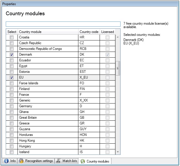

Country modules tab
Here you select the country modules that you want to use with a specific LPR camera. The list that you can select from, depends on which modules you have installed and your licenses (see XProtect LPR licenses).
A country module is a set of rules that defines license plates of a certain type and form belonging to a certain country, state or region.
Already licensed modules appear with a check mark in the Licensed column. If the country module you are looking for is not on your list, contact your vendor.
Name |
Description |
| Select |
Click to select or deselect a country module. The list of selected country modules on the right side updates automatically. |
| Country Module |
Lists the installed country modules. |
| Country Code |
Letters that identify a country module. |
| Licensed |
Shows if a country module is already licensed. You can select a licensed country module for as many cameras as you like. |
After changing the settings for your LPR camera, validate your configuration (see Validate configuration) to check if the system recognizes license plates as well as expected.
