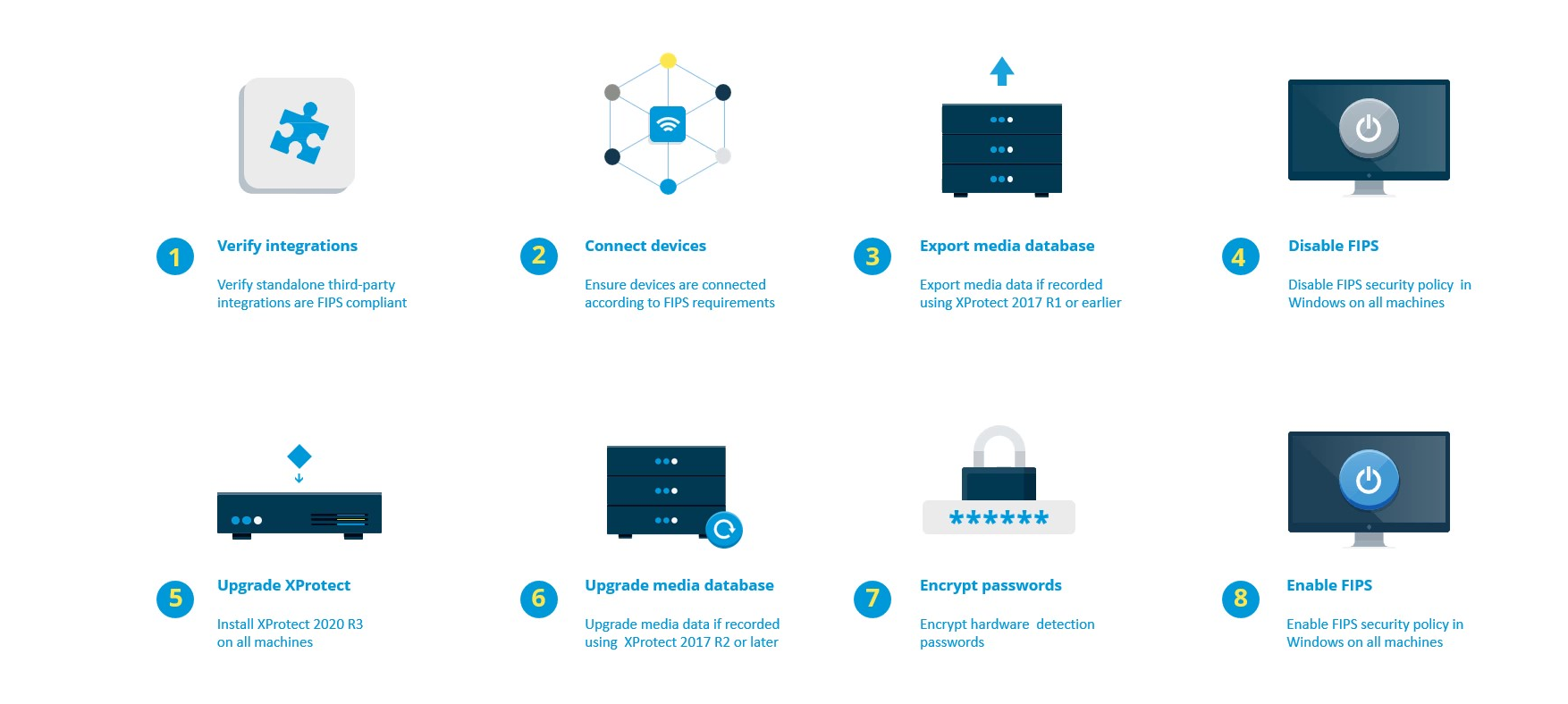

Recommended upgrade process for customers running XProtect VMS
- Start investigation whether third-party integrations are FIPS 140-2 compliant (see Verify third-party integrations).
- Prepare device connections to be FIPS 140-2 compliant (see Connect devices: background).
- Export recordings made with XProtect VMS versions that are older than 2017 R2 (see Media database: Considerations regarding backward compatibility).
This applies to customers who have encrypted or signed recordings at any point in time.
- Disable FIPS on the Windows operating system (see FIPS Group Policy on the Windows operating system).
- Install XProtect VMS2020 R3 (see Install XProtect VMS2020 R3).
- Upgrade the recordings in the media database that are made with XProtect VMS 2019 R3 or earlier (see Media database: Considerations regarding backward compatibility).

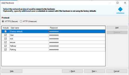

- Update the encryption of hardware discovery passwords (see Encrypt hardware detection passwords).
- Enable FIPS on the Windows operating system and restart all of the computers with XProtect VMS installed.

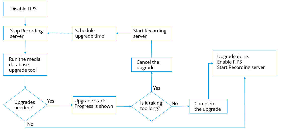

Media database upgrade: XProtect VMS 2017 R2 to XProtect VMS 2019 R3
If you are running a version of XProtect VMS between XProtect VMS 2017 R2 and XProtect VMS 2019 R3 and if at any point in time encryption has been enabled in the media database, in order to access these recordings you must do one of the following options.
Both options require the use of the media conversion tool. The recording server must be stopped while the media conversion tool is running, and there are no recordings being made while the tool is running. See What is the media conversion tool? for more information.

- Upgrade XProtect VMS to 2020 R3.
- With FIPS disabled on the Windows operating system, run the media conversion tool that is provided by Milestone support.
- Enable the FIPS Group Policy flag on the Windows operating system.

The media conversion tool is a stand-alone PowerShell script, that is delivered in source. It is not part of any installation.
It is to be distributed to customers only through Milestone support.
It can convert all storage in bulk, or it can be run on a specific storage.
Progress indicators show how far the tool has gotten.
If the conversion takes too long, you can cancel the job and continue without FIPS enabled.

After running the media conversion tool, the XProtect VMS 2020 R3 will be able to load tables in FIPS compliant mode.
Media conversion tool workflow
Media database upgrade: XProtect VMS 2020 R1 or XProtect VMS 2020 R2
If you are running XProtect VMS version 2020 R1 or XProtect VMS 2020 R2, media data that is recorded with one of these versions will be automatically re-encrypted with FIPS 140-2 compliant algorithms during the recording server upgrade.
FIPS mode of operation is enabled and disabled with the FIPS Group Policy flag on the Windows operating system. See the Microsoft site for information on enabling and disabling FIPS.
Before you upgrade, you must disable the FIPS Group Policy flag on all the computers that are part of the XProtect VMS, including the computer that hosts the SQL Server and all XProtect Smart Client workstations.
There are two reasons why the FIPS Group Policy flag must be disabled on all computers in the XProtect VMS before you upgrade:
- During the upgrade, data that is encrypted with non-approved FIPS algorithms is re-encrypted with approved algorithms. In order to run the decryption on the Windows operating system, the FIPS Group Policy flag must be disabled.
- If the FIPS Group Policy flag is enabled in Windows, you will not be able to use the XProtect VMS until all components are upgraded. For example, a 2020 R2 XProtect Smart Client will not be able to communicate with a 2020 R3 Management Server if the Management Server is on a computer that has the FIPS Group Policy flag enabled.
FIPS Group Policy and Milestone Federated Architecture
If any site in a Milestone Federated Architecture must operate with the FIPS Group Policy flag enabled in Windows, then all of the sites must also operate with the FIPS Group Policy flag enabled in Windows.
In consequence, the entire Milestone Federated Architecture installation must be upgraded to version 2020 R3.
When you upgrade, the XProtect VMS installer will check the FIPS security policy and will prevent the upgrade from starting if FIPS is enabled.
The hardware detection passwords must be updated after you upgrade to XProtect VMS 2020 R3.
The encryption of the hardware detection passwords is not updated during upgrade from earlier version of XProtect VMS. But, these passwords cannot be read if the FIPS Group Policy flag is enabled in Windows.

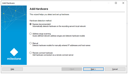

You must trigger a conversion of these passwords before you enable FIPS. Do the following:
- Make sure the FIPS Group Policy flag is disabled in Windows.
- In XProtect Management Client, open the Add Hardware wizard.
- Select the detection method to open the hardware detection page.
This triggers the re-encryption of the hardware detection passwords with FIPS-compliant algorithms.
The credentials are now encrypted with FIPS-compliant algorithms.
