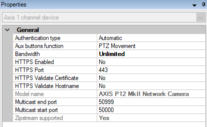

Axis drivers
Do the following:
- Set HTTPS Enabled to Yes.
 - Set HTTPS Validate Certificate to Yes.
 - Set HTTPS Validate Hostname to Yes.

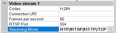

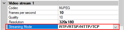

- For every enabled media channel and media stream, set Streaming Mode to RTP/RTSP/HTTP/TCP.

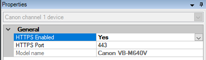

Canon drivers
- Set the HTTPS Enabled to Yes.

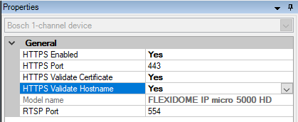

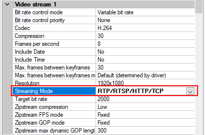

Bosch drivers
Do the following:

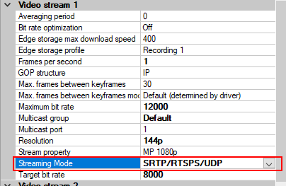

- For every enabled media channel and media stream, set Streaming Mode  to one of the following:
- RTP/RTSP/HTTP/TCP
 - SRTP/RTSPS/UDP
 - SRT/RTSPS/UDP multicast

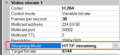

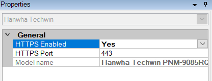

Hanwha drivers
- For every enabled media channel and media stream, set Streaming Mode to HTTP streaming.

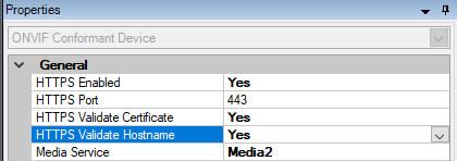

Do the following:

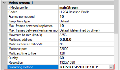

- For every enabled media channel and media stream, set Streaming method to RTP/RTSP/HTTP/TCP.

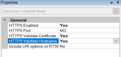

Do the following:

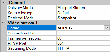

- For every enabled media channel and media stream, set Streaming Mode to either RTP/RTSP/HTTP/TCP or HTTP, depending whether streaming or snapshot retrieval mode is used.
