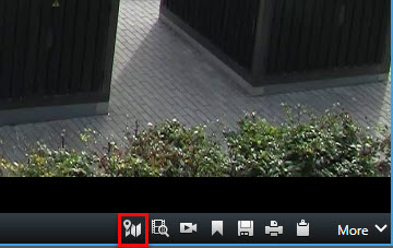

While searching for video and related data on the Search tab, you can locate the cameras geographically in the preview area:
When you select a search result, the smart map zooms in on the associated camera in its geographic location. You may need to zoom out to get a better overview of the surroundings.

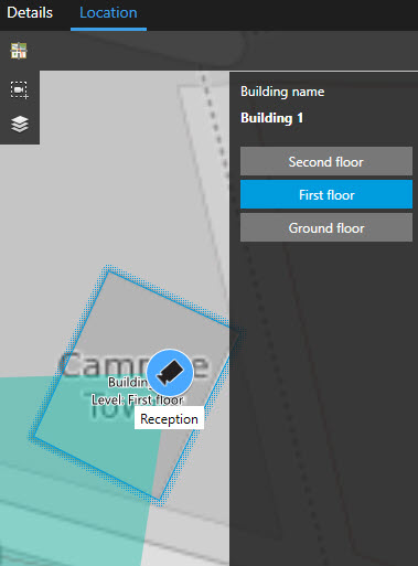

If the camera is placed somewhere inside a multistory building, an indication of the level of the camera appears:
If a camera is visible on multiple levels, only the first level specified is displayed, from the bottom and up.
