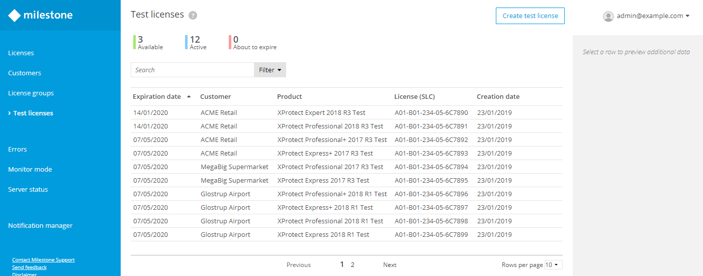

Manage test licenses in Milestone Customer Dashboard

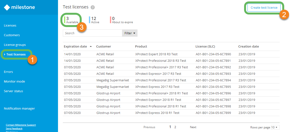

Test licenses that you have created are displayed as a table and sorted by Expiration date by default. Use the Search field to search for test licenses by Customer name, Product, or associated License (SLC).

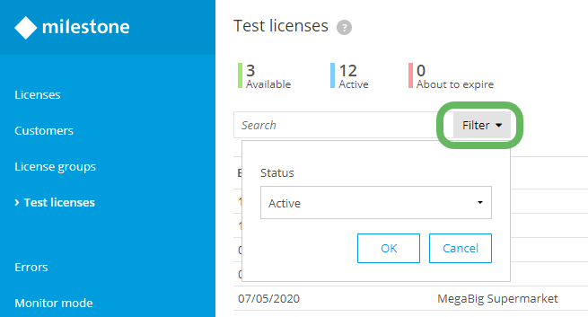

On the Test licenses page, select the Filter dropdown list to see test licenses according to Status (Active, Inactive, or About to expire). Inactive test licenses are licenses that are deactivated or have expired, and do not count against your pool of available licenses.

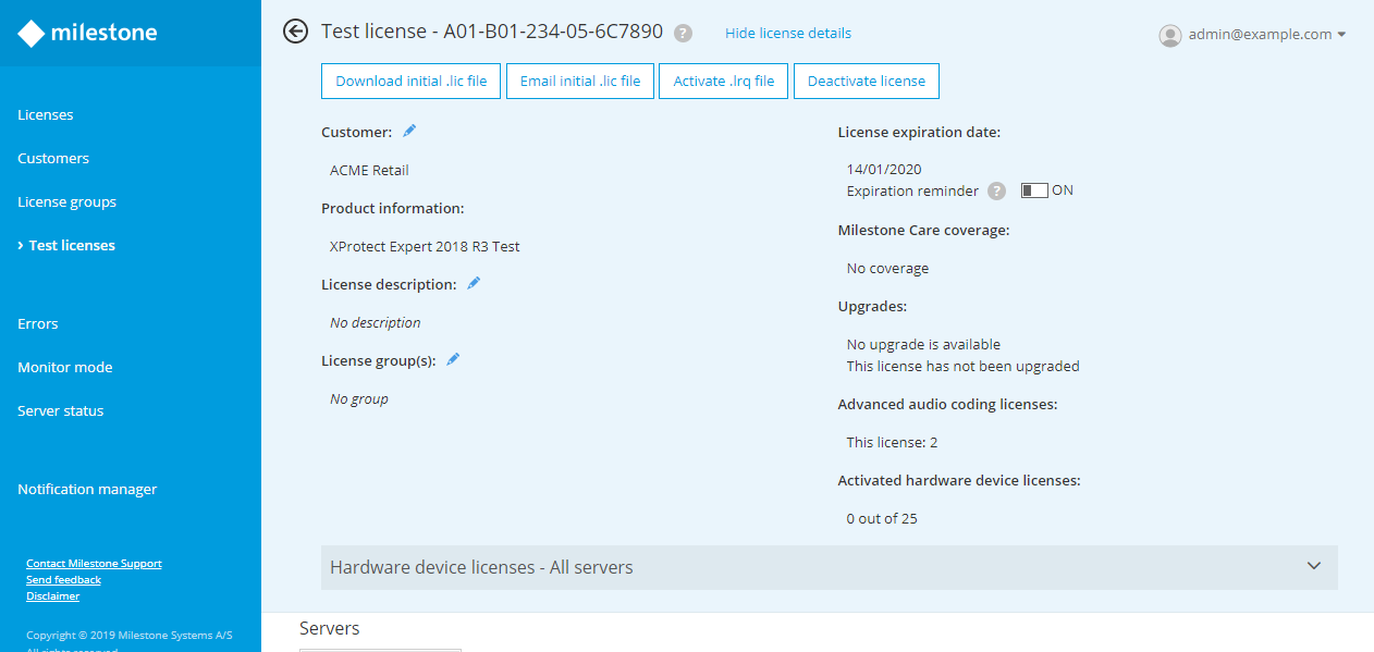

Double-click a test license to view the details of the test license. On this page, see the associated Customer and Product, as well as Activated hardware device licenses.
Select next to the Customer, License description, and License group(s) fields to:
  • Associate the test license with another customer
  • Add a license description
  • Add the test license to a license group, respectively
You can see the License expiration date for the selected test license and enable email reminders by turning on Expiration reminder. Email reminders are sent 100 and 20 days before the license expires.
Select Download initial .lic file, Email initial .lic file, and Activate .lrq file to enable the selected test license in your VMS installation. For more information about working with .lic and .lrq files, see Get a software license (.lic) file in Milestone Customer Dashboard.

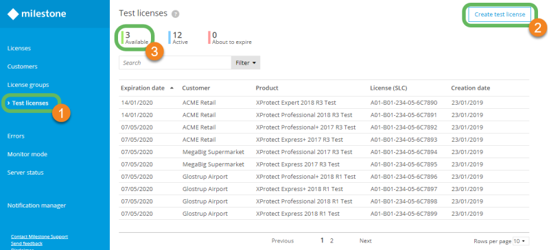

Test licenses are used for demonstration and training purposes of Milestone products. To create a test license:
  1. Log in to Milestone Customer Dashboard (https://online.milestonesys.com/).
  2. In the main menu, select Test licenses .
  3. Select Create test license .
    If you have zero Available test licenses to create, Create test license is disabled. You must deactivate a test license to increase your number of available test licenses. For more information, see Deactivate a test license in Milestone Customer Dashboard.

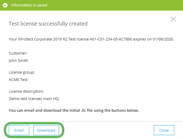

  8. Select Next to confirm test license creation.
After completion, the test license confirmation dialog box shows your newly activated test license and the associated product, version number, customer, and expiration date.
To use this test license on a new VMS installation, select Email or Download in the test license confirmation dialog box.

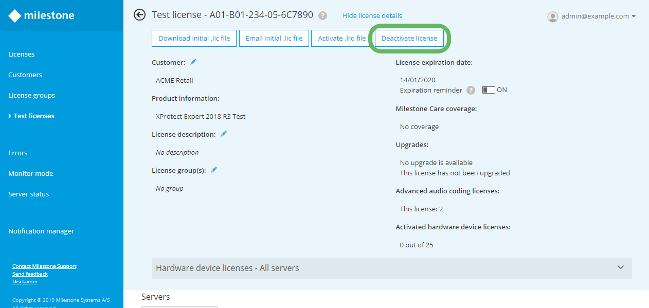

To deactivate a test license:
  2. In the main menu, select Test licenses.
  3. Double-click to select the test license that you want to deactivate.
  4. On the license details page, select Deactivate license.
  5. In the Are you sure that you want to deactivate this test license? dialog box, select Deactivate.

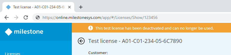

An orange notification bar informs you that the license is no longer active, and your pool of Available test licenses increases.
The license details page continues to show the deactivated license information for reference.
