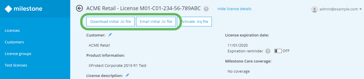

  1. Log in to Milestone Customer Dashboard (https://online.milestonesys.com/).
  2. Select Customers or Licenses in the main menu.
  3. On the Customers tab, double-click a customer, then double-click an associated License (SLC). Alternatively, double-click an SLC on the Licenses tab.
  4. Select Download initial .lic file to download the license file directly, or select Email initial .lic file to open the Email initial license file dialog to send an email containing the license file to one or more recipients.
The license (SLC) must be associated with a product version 8.1 or newer and must not be a plug-in license in order to provide a software license (.lic) file.

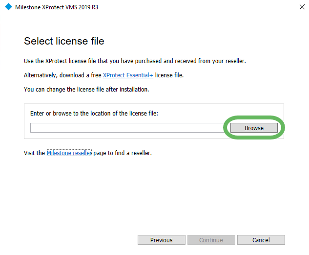

To import a software license (.lic) file:
  1. Find the downloaded license file on your computer. Alternatively, find the email with the software license file attached and copy the license file to your computer.
  2. Run the XProtect VMS product installer.
  3. In the Select license file window, select Browse, locate the software license file, then select Continue.
After you add devices, you must activate hardware device licenses for them. Depending on whether the system is connected to the internet, follow the steps for Use online activation or Use offline activation.

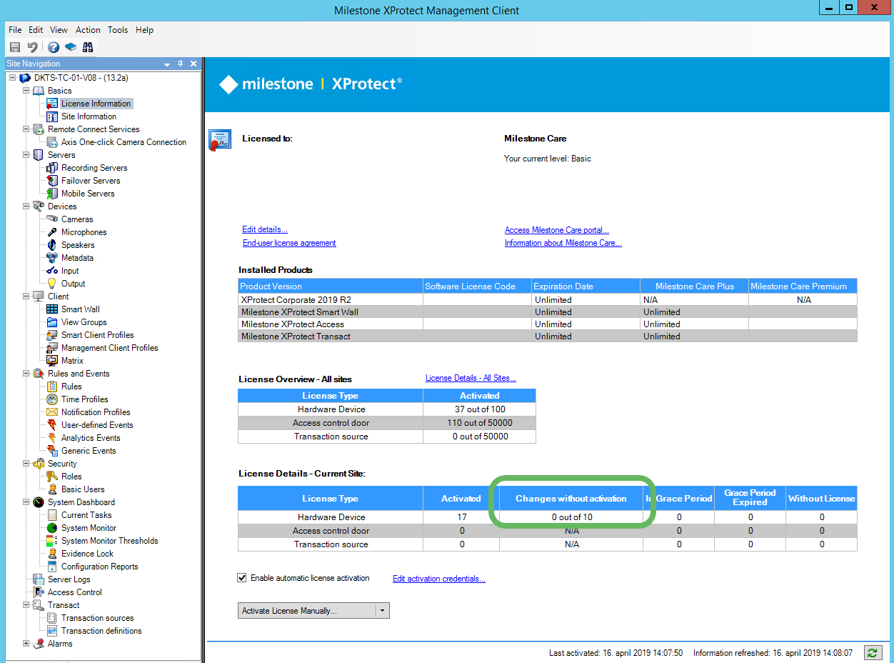

You can change a certain number of cameras without having to activate device licenses again, called Changes without activation. The number of changes that you can make is refreshed annually and is based on usage conditions, such as your XProtect VMS product and the number of device licenses that you have purchased.
See the current list of variable values on the Milestone device calculation web page (https://www.milestonesys.com/device-change-calculation/). You can learn more about changes without activation in the Management Client help system.
To view your changes without activation:
  1. Open Management Client.
  2. Select License Information.
  3. In the License Details - Current Site section, the number is shown under Changes without activation.

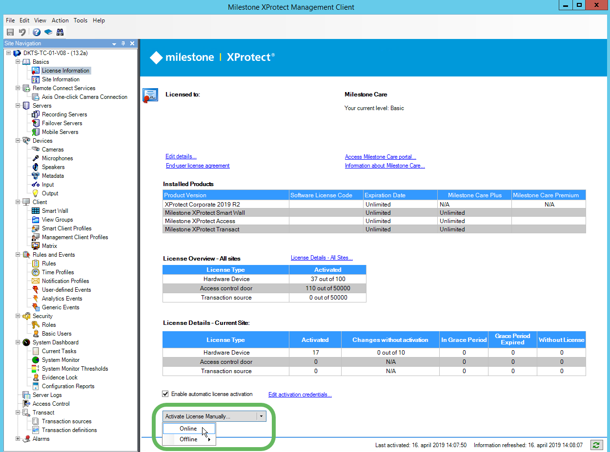

Start online activation manually
  1. In Management Client, in the Site Navigation pane, expand Basics, and select License Information.
  2. Select Activate License Manually, then select Online.
  3. Enter the user name and password for your (Undefined variable: Variables.MyMil) account, then select Next.
  4. Select Finish to activate the licenses.

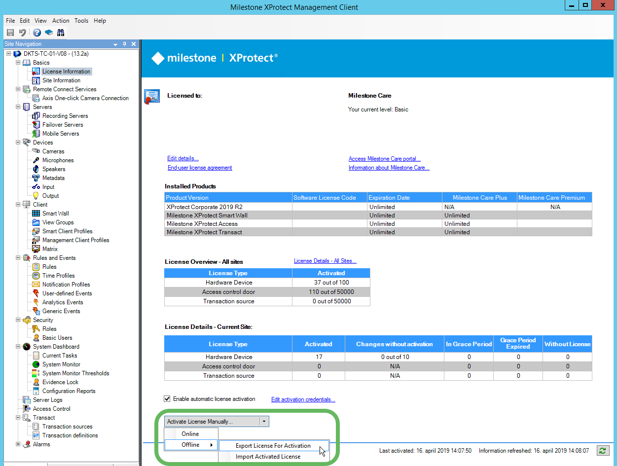

Export a license request (.lrq) file from Management Client
The license request file contains information about your XProtect VMS system. For example, it contains the number of hardware devices for which to activate licenses.
To export a license request (.lrq) file:
  2. At the bottom left-hand side of the main workspace, select Activate License Manually > Offline > Export License For Activation.
  3. Save the license request (.lrq) file to a portable storage device.

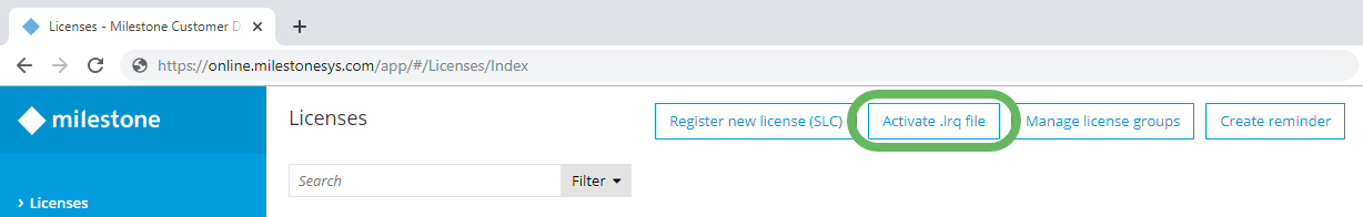

Activate a license request (.lrq) file in Milestone Customer Dashboard
  1. Log in to Milestone Customer Dashboard.
  2. Select Customers & Licenses, then select Activate .lrq file.
  3. Select Activate .lrq file, and then find the license request (.lrq) file that you saved on the portable storage device.
  4. Optional: By default, the activated license file is sent to the email address that was specified when the software license was purchased. To add more email recipients for the activated license file, enter the recipients' email addresses in the Enter additional recipients (optional) field and select Add.
  5. Select Upload.
