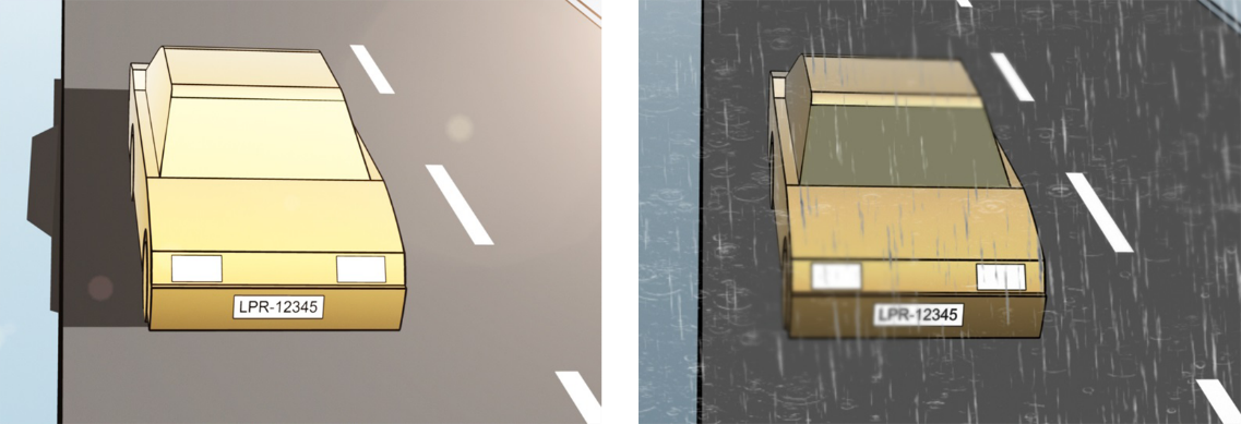

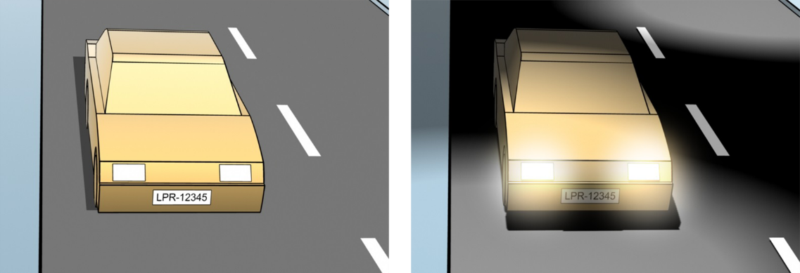

As a guideline, capture snapshots of vehicles in the real physical surroundings and conditions, in which you want to be able to recognize license plates.
The list below illustrates examples of the situations that you should consider when you capture and select snapshots. Not all may be applicable to your surroundings.
Milestone recommends that you select minimum 5-10 snapshots that represent typical conditions of:
- The weather; for example, sunlight and rain
- The light; for example, daylight and nighttime

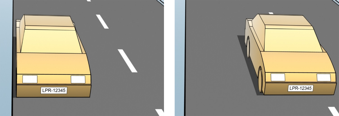

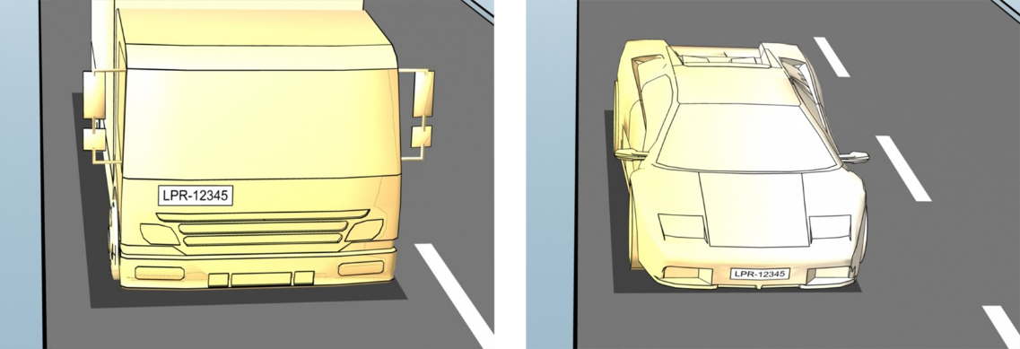

- Vehicle types; to define the top and bottom of the recognition area
- Position in the lane; to define the left and right of the recognition area
- Distance to the car; to define the area where LPR analyzes license plates

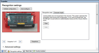

Recognition area
To ensure best performance and avoid false recognitions, Milestone recommends that you select a clearly defined and "well-trimmed" recognition area. The area should cover only the part of the image where the license plate is visible and remains visible as the vehicle moves in and out of the image. Avoid irrelevant moving objects (people, trees, traffic) in the recognition area (see Positioning the camera).
License plates are not recognized in the red area.
When specifying a recognition area, you can click:
- Clear to remove all selections and select new areas for LPR
- Undo to revert to your last saved recognition area
After changing the settings for your LPR camera, validate your configuration (see Validate configuration) to check if the system recognizes license plates as well as expected.

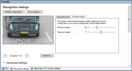

Character height
Define the minimum and maximum height of the license plate characters (in percent). Select character heights as close as possible to the height of the characters in the real license plate.
These character settings affect the recognition time and process. The smaller the difference between the minimum and the maximum character height:
- The smoother the LPR process
- The lower the CPU load
- The sooner you get the results
The overlay in the snapshot displays the currently defined character height setting. The overlay grows and shrinks proportionally to the character height settings to the right. For easy comparison, drag the overlay on top of the real license plate in the snapshot. Zoom with your mouse wheel for a closer look.

Minimum height |
Set the minimum character height for including license plates in the recognition process. If the real license plate characters are smaller than the value you specify, the system will not start the recognition process. |
Maximum height |
Set the maximum character height for including license plates in the recognition process. If the real license plate characters are bigger than the value you specify, the system will not start the recognition process. |

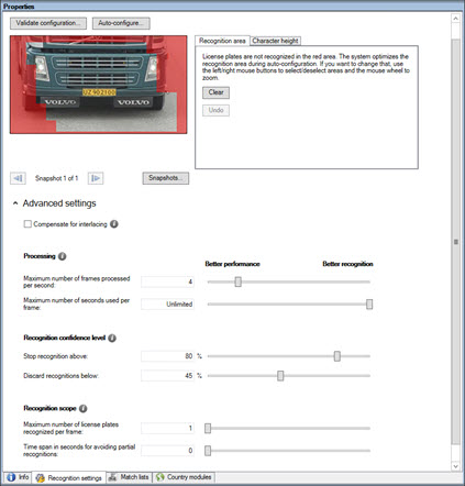

Advanced settings
The recognition process has two steps: 1) finding the plate(s) and 2) recognizing the characters in the plates. Click Advanced settings to define a trade-off between processing speed and recognition quality.
High recognition quality:
- Needs higher computational effort
- Increases CPU load
- Takes more time to return results
When the optimal results are met, the recognition process stops and returns the license plate it recognized at that point.
Name |
Description |
Compensate for interlacing |
If your LPR camera records interlaced video, and you see a combing effect in the de-interlaced image in LPR, select this check box. This may improve image quality and recognition results. |
Maximum number of frames processed per second |
Limit the number of frames your system processes every second. If you keep this setting low, you can increase the frame rate on your camera without adding unnecessary load to your LPR server. Unlimited: Remove the top limit. You will risk increasing the processing time and the CPU load. |
Maximum number of seconds used per frame |
Limit the number of seconds your LPR can spend on recognizing one frame. If adjusted, the recommended value is 0.2 seconds per frame. Unlimited: Remove the top limit. You will risk increasing the processing time and the CPU load. |
Stop recognition above |
Stop recognition when a license plate is recognized with a confidence level equal to or above the value you specify. |
Discard recognitions below |
Discard recognitions with a confidence level below the value you specify. Increase this value to get fewer but possibly more accurate recognitions. Decrease this value to get more but potentially less accurate recognitions. The smaller the difference between Stop recognition above and Discard recognitions below values, the lower the processing time and the CPU load. |
Maximum number of license plates recognized per frame |
Recognize several license plates simultaneously. For example, relevant for cameras recording multi-lane roads, where many license plates must be recognized at the same time. Unlimited: Remove the top limit. You will risk increasing the processing time and the CPU load. |
Time span in seconds for avoiding partial recognitions |
Delay all recognitions for the time period you specify. This is to avoid that the same license plate is recognized several times as different license plates. The system will wait for a better recognition and only accept the most complete recognition. Before changing this setting, ensure no irrelevant moving objects (see Camera angles) block the view of your LPR camera. |

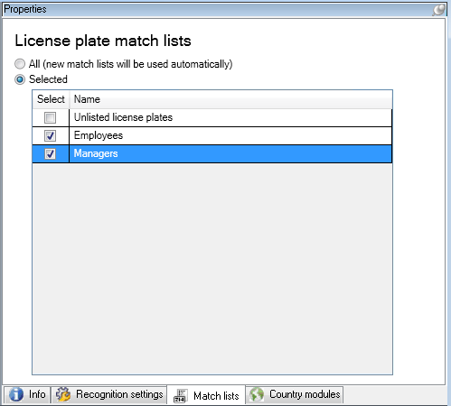

Match lists tab
On this tab you select which license plate match list(s) you want a specific LPR camera to match license plates against. You can create as many lists as you need (see Add new license plate match lists).
Name |
Description |
All |
License plates are matched against all available and future lists. |
Selected |
License plates are matched against the selected lists only. Select one or more from the available lists. |

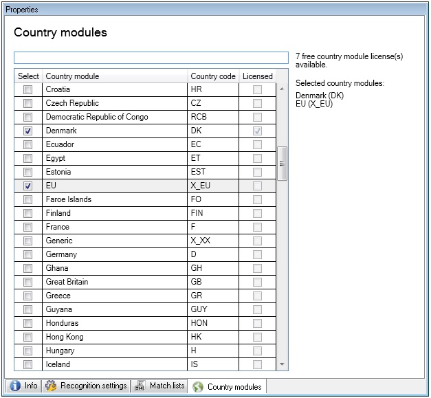

Country modules tab
Here you select the country modules that you want to use with a specific LPR camera. The list that you can select from, depends on which modules you have installed and your licenses (see XProtect LPR licenses).
A country module is a set of rules that defines license plates of a certain type and form belonging to a certain country, state or region.
Already licensed modules appear with a check mark in the Licensed column. If the country module you are looking for is not on your list, contact your vendor.
Name |
Description |
Select |
Click to select or deselect a country module. The list of selected country modules on the right side updates automatically. |
Country Module |
Lists the installed country modules. |
Country Code |
Letters that identify a country module. |
Licensed |
Shows if a country module is already licensed. You can select a licensed country module for as many cameras as you like. |
