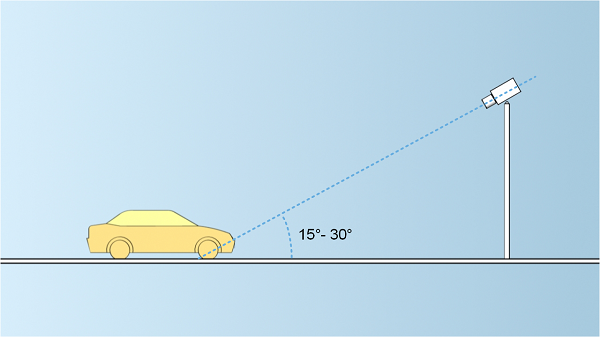

  • Vertical angle: The recommended vertical view angle of a camera used for LPR is between 15°-30°.

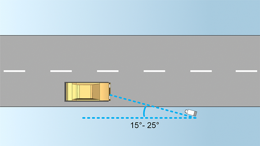

  • Horizontal angle: The recommended maximum horizontal view angle of a camera used for LPR is between 15°-25°.
