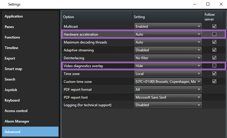

  1. Go to Settings > Advanced > Hardware acceleration.
  2. Select the default setting Auto.
    Hardware acceleration settings in XProtect Smart Client.
