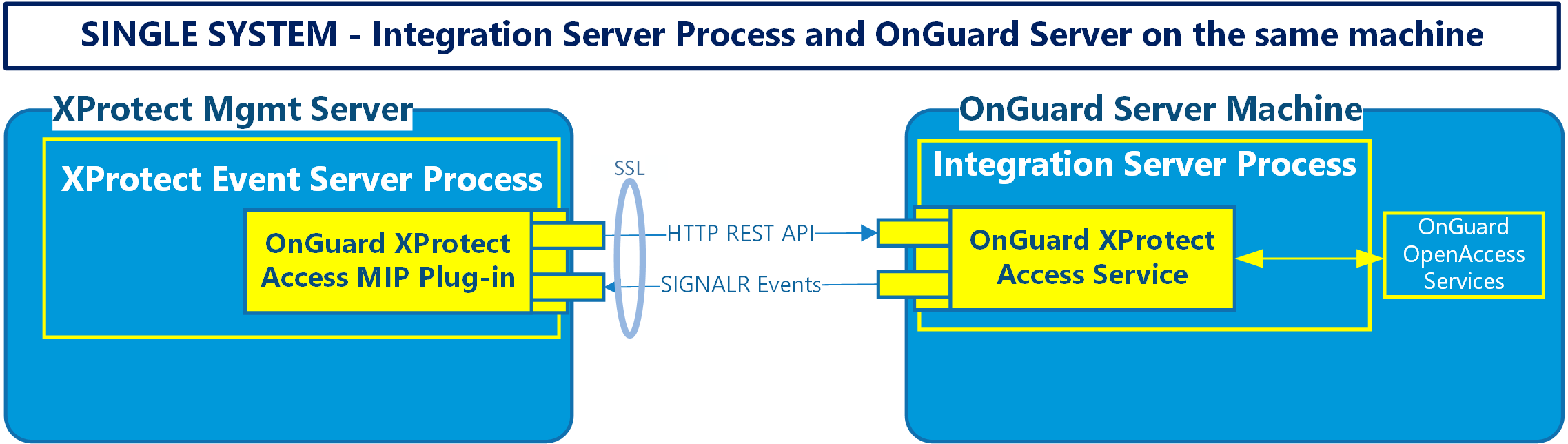

Single system scenario
For most systems, this is the recommended installation scenario.
First - install the XProtect OnGuard Integration Service on the OnGuard server
Second - install the XProtect OnGuard Integration MipPlugin on the XProtect server
