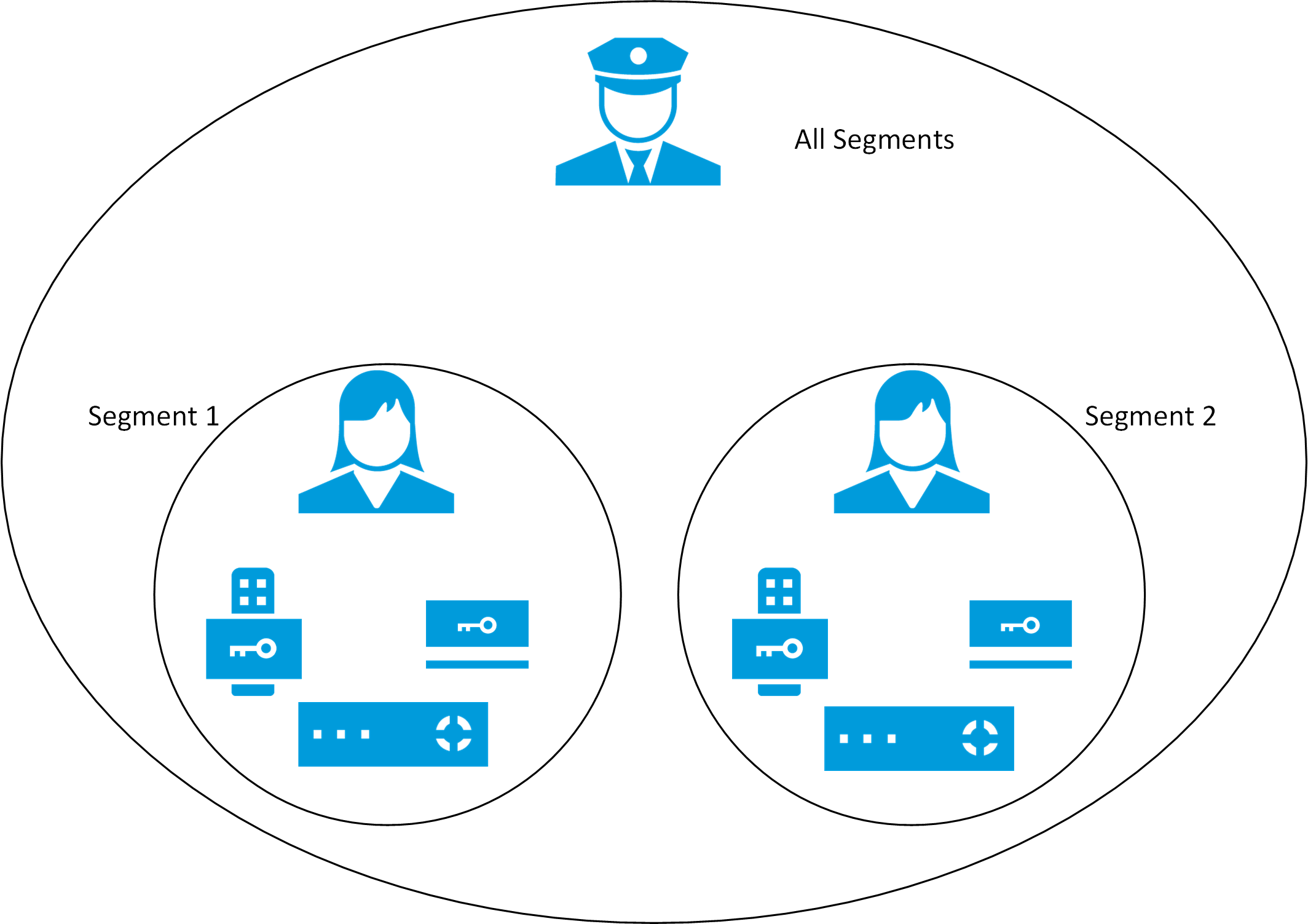

Personalized login can control which devices, events, and alarms users can view in the Smart Client when integrated with segmented OnGuard systems. A segmented OnGuard system uses logical groupings, known as segments, to define which access panels, readers, cardholders, and users work together.

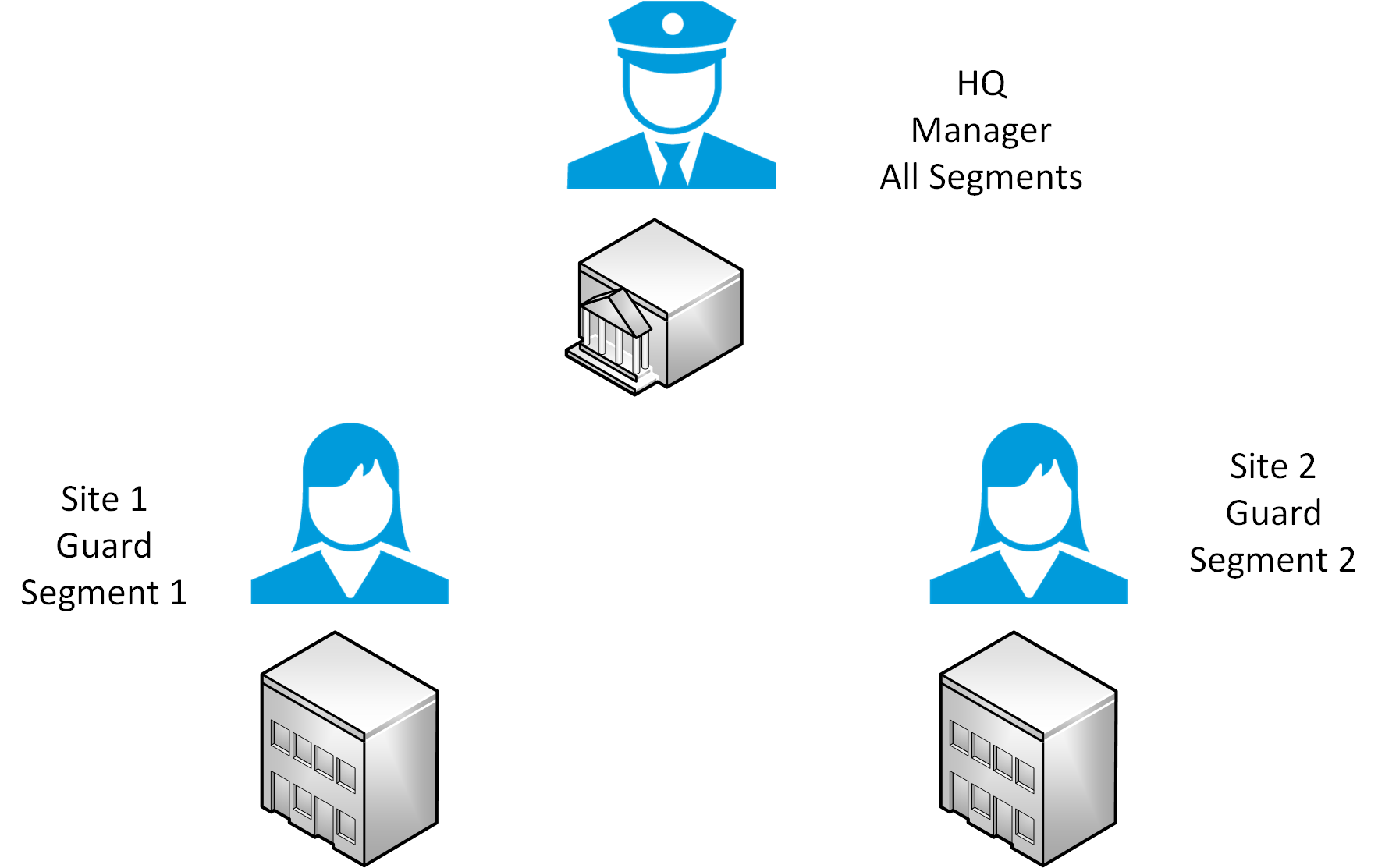

Illustrated below is an organization with three sites, a head quarters, site 1, and site 2.
Using segments, the guard user at site 1 can see readers, panels, and cardholders from segment 1, and the guard user from site 2 can see the devices and information from segment 2. The manager can see all devices and information, since they're in the default "All Segments" segment.
