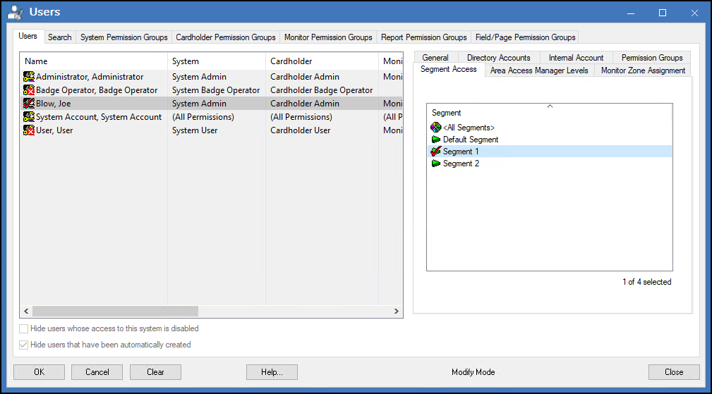

  1. Go to the Users sub-menu in the Administration menu of the OnGuard System Administration application.
  2. Click Modify.
  3. Select the Segment Access sub-tab.
  4. In the Segment listing window, select the segment(s) the user has access to.
  5. Click OK to save the changes.

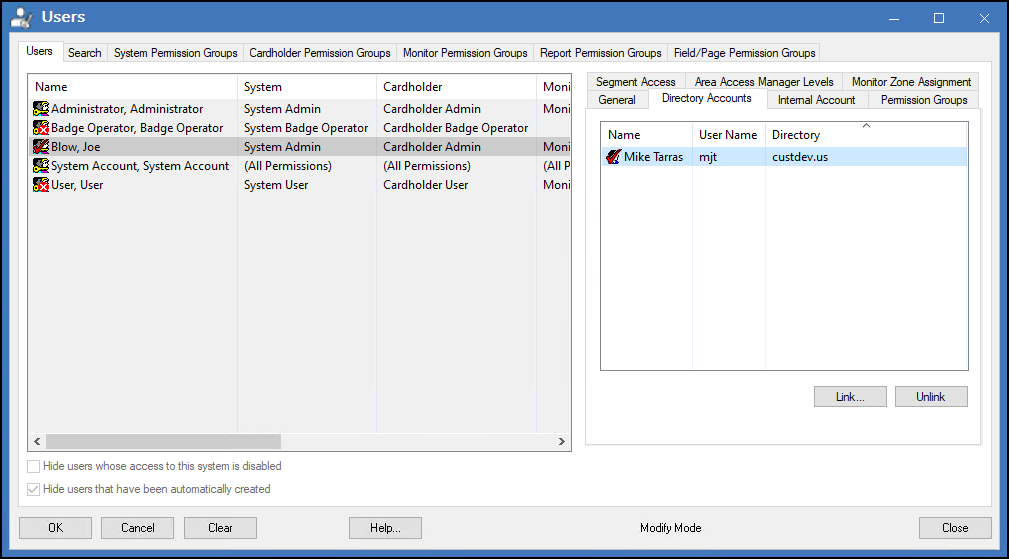

It's recommended to map users logically from your domain, to XProtect, to OnGuard and to their segment. This lets SSO in XProtect work with the personalized log-in feature, and with segments within OnGuard, to simplify the log-in experience, while also customizing and controlling the integrated Smart Client.
You can map OnGuard users to a domain user within XProtect in the Directory Accounts sub-tab of the Users sub-menu of the Administration menu in the OnGuard System Administration application.
