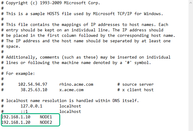

Map the host names of the nodes
If you do not have a DNS server to resolve the host names of Node 1 and Node 2, you must map their IP address to host names manually.
On Node 1, go to
C:\Windows\System32\drivers\etcand open the hosts file as administrator with a text editor such as Notepad.Under the section
localhost name resolution is handled within DNS itself, specify the IP address of Node 1 and its host name. On a new line, add the IP address of Node 2 and its host name.
Repeat the same steps on Node 2.
