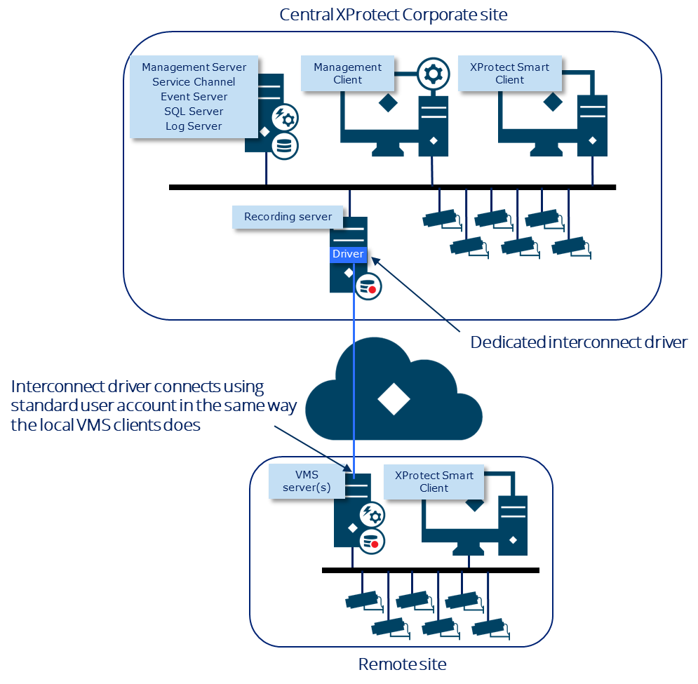

The actual connection between the central XProtect Corporate site and the remote VMS site is established through a driver in the XProtect Corporate recording server, in the same way as when connecting to a network camera or a video encoder.
This diagram shows how the central XProtect Corporate site and the remote VMS site are interconnected via the dedicated driver in the XProtect Corporate recording server.

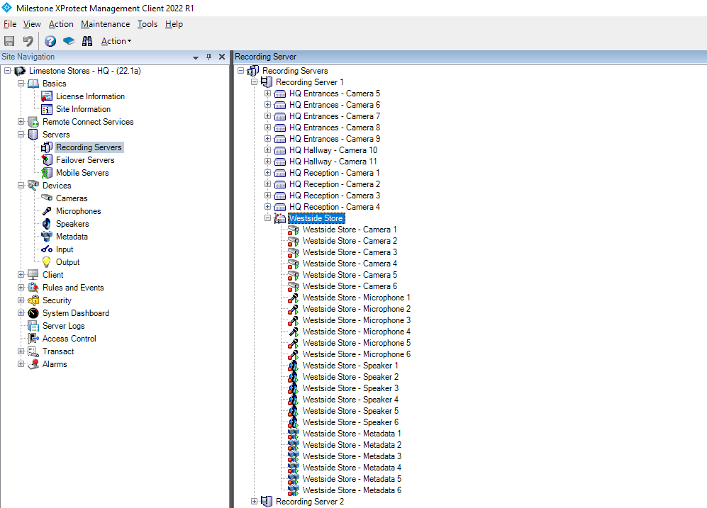

Since the remote site is interconnected via the recording server, the remote site appears in the XProtect Management Client on the central XProtect Corporate site as a kind of multi-channel video encoder, listing the cameras, microphones, speakers, and metadata devices that can be accessed on the remote interconnected site.
Interconnected site added to the recording server in XProtect Management Client
Because the interconnected cameras, microphones, speakers, and metadata devices are listed as if they were connected to a video encoder, they can be used and administrated in the central XProtect Corporate site in the same way as any standard camera that is connected directly. The only exception is changing the actual image, audio, or metadata settings on the devices. These settings are controlled on the remote site.
