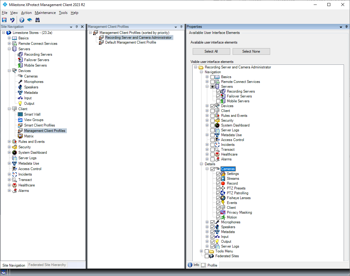

Management Client profiles are located under the ‘Client’ node in the XProtect Management Client.
When a Management Client profile is selected, the user interface elements that can be turned on or off are shown on the ‘Profiles’ tab. Some nodes, like for instance the ‘Camera’ node, can be expanded to show futher elements that can be controlled.
Management Client Profiles node selected in XProtect Management Client – Provides access to recording servers and devices
In above example, the created ‘Recording Server and Camera Administrator’ profile provides access to the user interface elements needed to manage recording servers and devices.

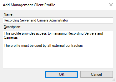

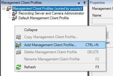

Right-click the ‘Mangement Client Profiles’ pane and select‘ Add Management Client Profile‘.
Assign a name to it and, optionally, enter a description
Management Client Profiles, right-click menu in XProtect Management Client
Management Client Profiles, Add Management Client Profile from XProtect Management Client

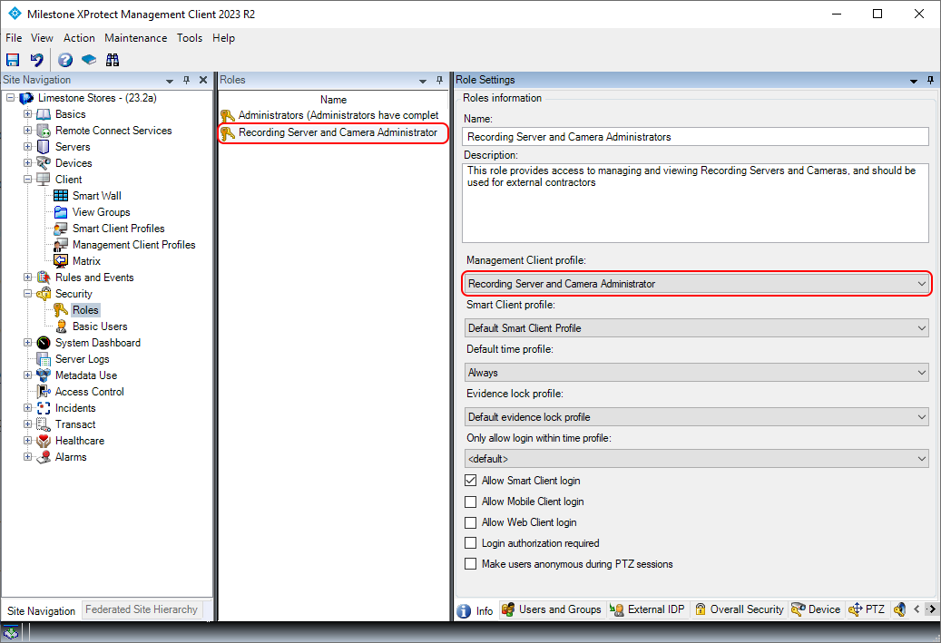

Having created a Management Client profile, the next step is to use it in a role:
Create or select a role with management rights
In the ‘Info‘ tab’s ‘Management Client profile:‘ dropdown, select the created profile.
Selecting a Management Client Profile for a role from XProtect Management Client
When users in this role log in with the XProtect Management Client, it will only show the user interface elements that have been enabled in the Management Client profile. All other elements are removed.

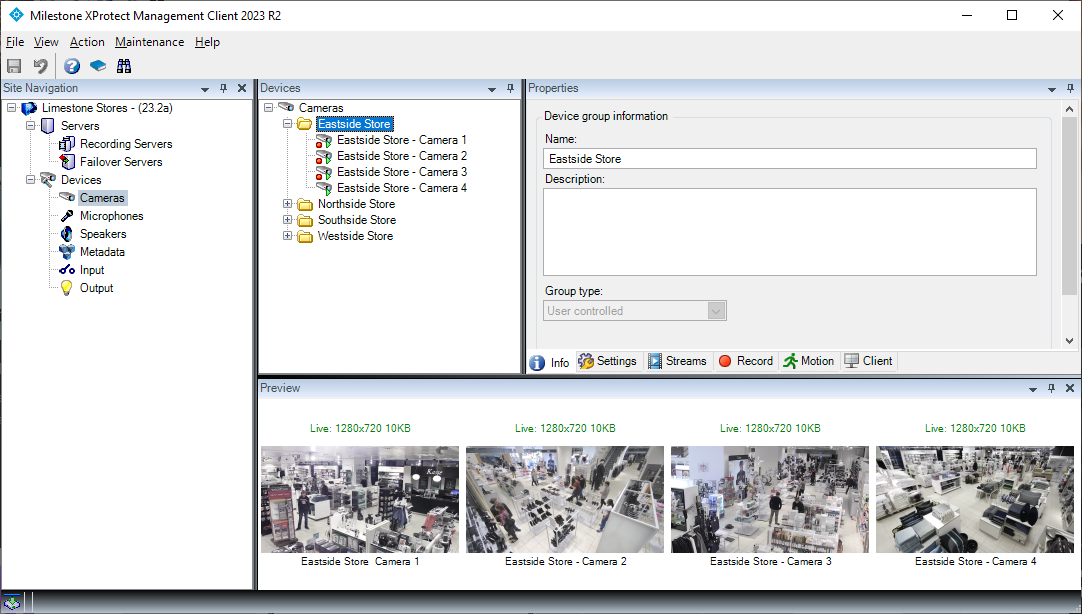

The screenshot below shows how the XProtect Management Client looks with only recording servers and devices enabled in the Management Client profile.
Management Client limited to only show the management interface for recording servers and cameras

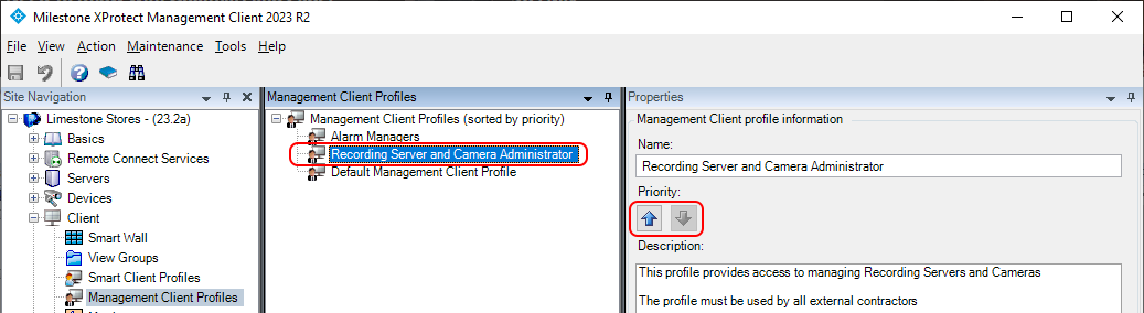

Multiple Management Client profiles
If the administrator logging in with the XProtect Management Client is a member of multiple roles configured with different Management Client profiles, the profile with the highest priority will be assigned.
Setting the priority of the Management Client Profiles - highest priority at the top of the list.
The profile priority is set by changing the order of the Management Client profiles in the ‘Management Client Profiles’ pane. The profiles are listed with highest priority at the top, and lowest at the bottom. The priority can be changed by clicking the ‘Priority:’ up/down buttons.
