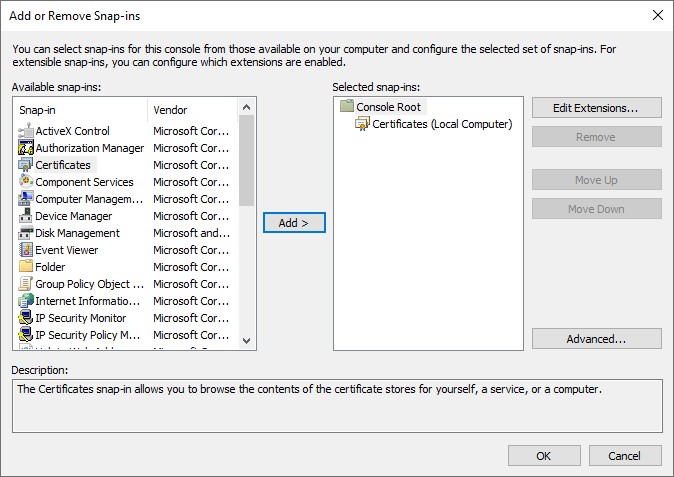

  1. On the computer that hosts the XProtect server, open the Microsoft Management Console.
  2. In the Microsoft Management Console, from the File menu select Add/Remove Snap-in….
  3. Select the Certificates snap-in and click Add.

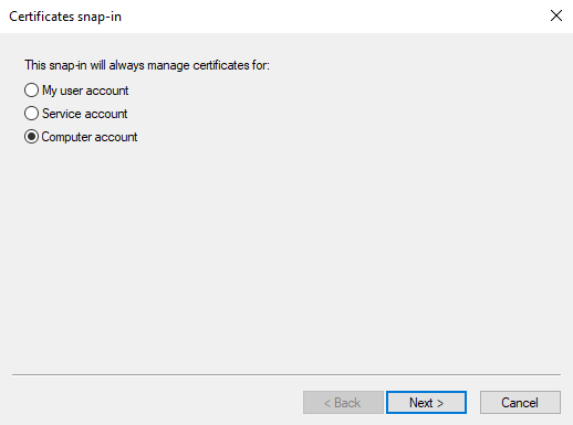

  4. In Certificates snap-in, select Computer account.

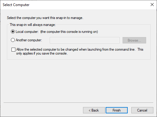

  5. In Select Computer, select Local computer.
    Select Finish, then OK.

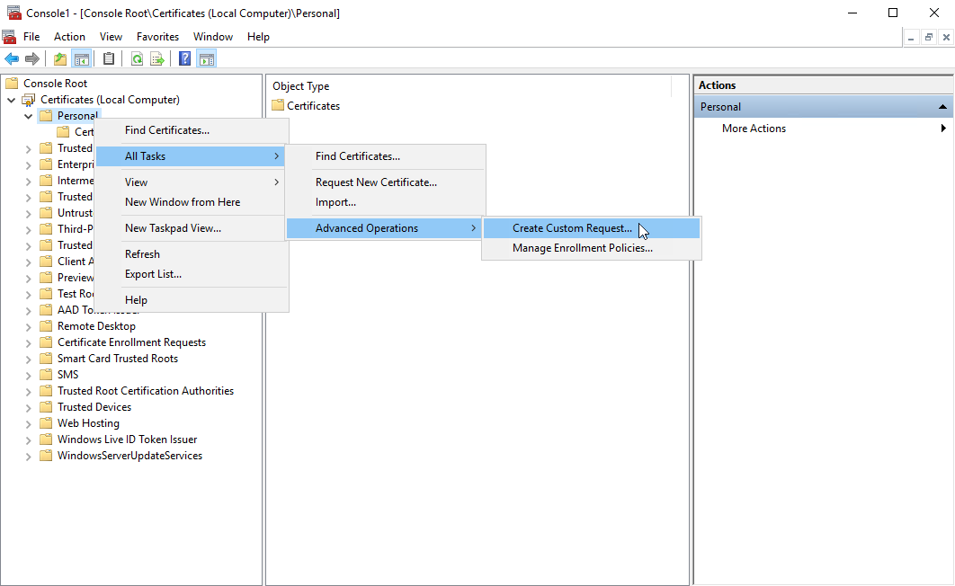

  6. Expand the Certificates object. Right-click on the Personal folder and select All Tasks > Advanced Operations > Create Custom Request.
