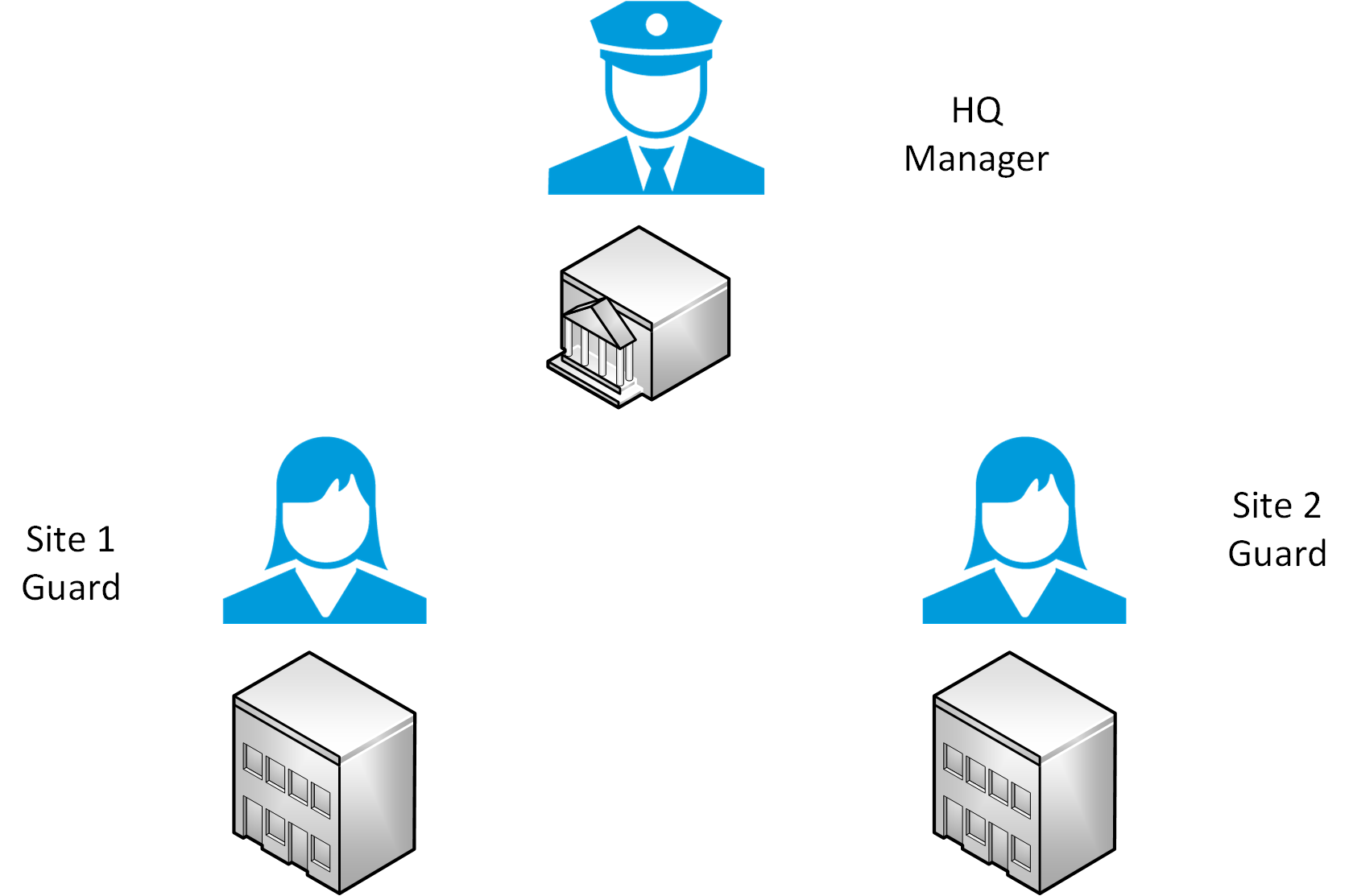

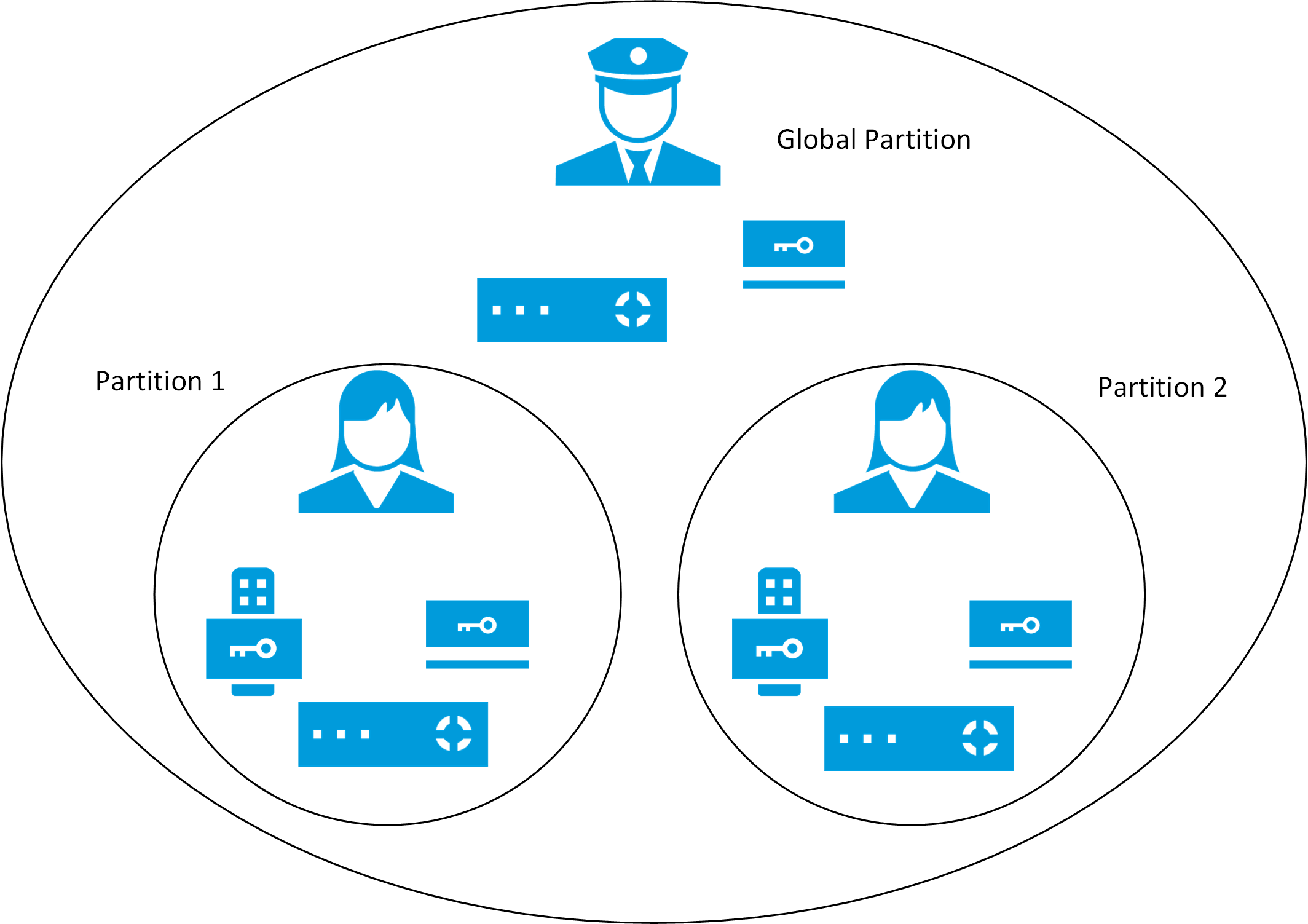

Illustrated below is an organization with three sites, a headquarters, site 1, and site 2.
Using partitions, the guard user at site 1 can see readers, panels, and cardholders from partition 1, and the guard user from site 2 can see the devices and information from partition 2. The manager can see all devices and information, since they're in the default "Global" partition.

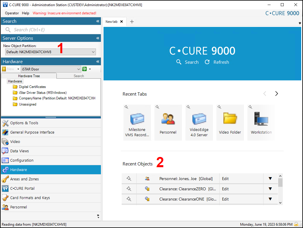

The default interface has several menu options that show information about current partitions.

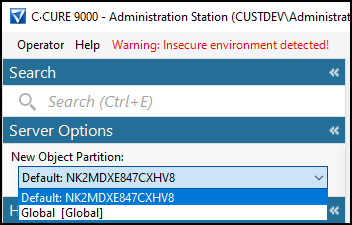

  1. The New Object Partition menu allows filtering the client's menus, options, and user privileges based on the selected partition.

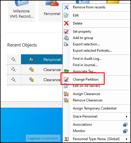

  2. Any menu option that provides the operator the ability to interact with individual objects, devices, or personnel can have options for that object's partition.

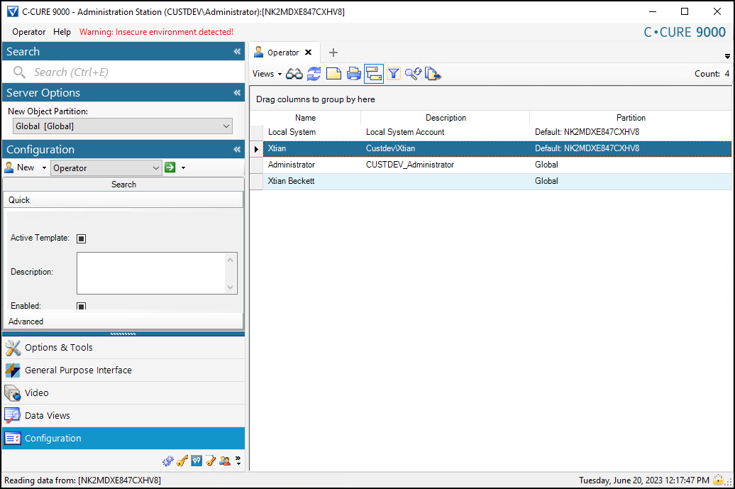

Map users to partitions.
  1. Go to the Configuration tab in the Administration Station and search for operators in the chosen partition.
  2. Add new users, Domain users, and assign partitions.
