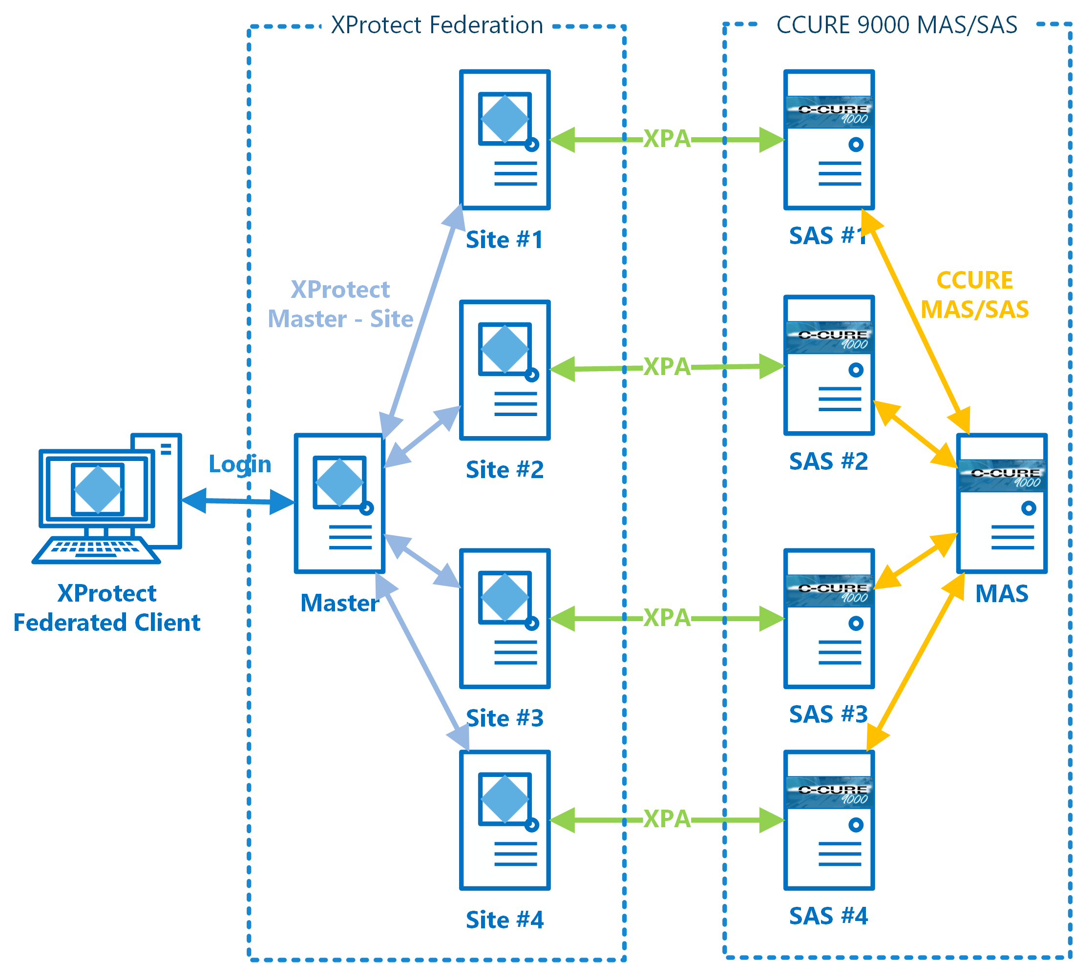

CCure 9000: Enterprise (MAS/SAS) configuration
If the CCure 9000 system is part of an Enterprise deployment (MAS/SAS), the Enterprise system must be correctly configured and functioning before setting up the integration. Each CCure 9000 Satellite Application Server (SAS) of an Enterprise deployment must be independently connected through XProtect Access (XPA) to one Milestone XProtect Site of a Federated system.
Important

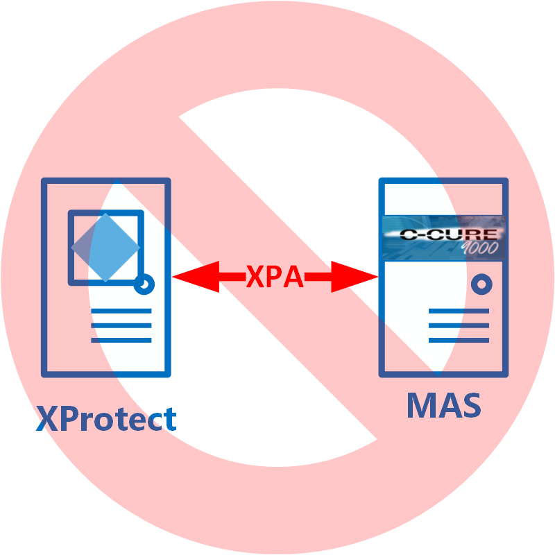

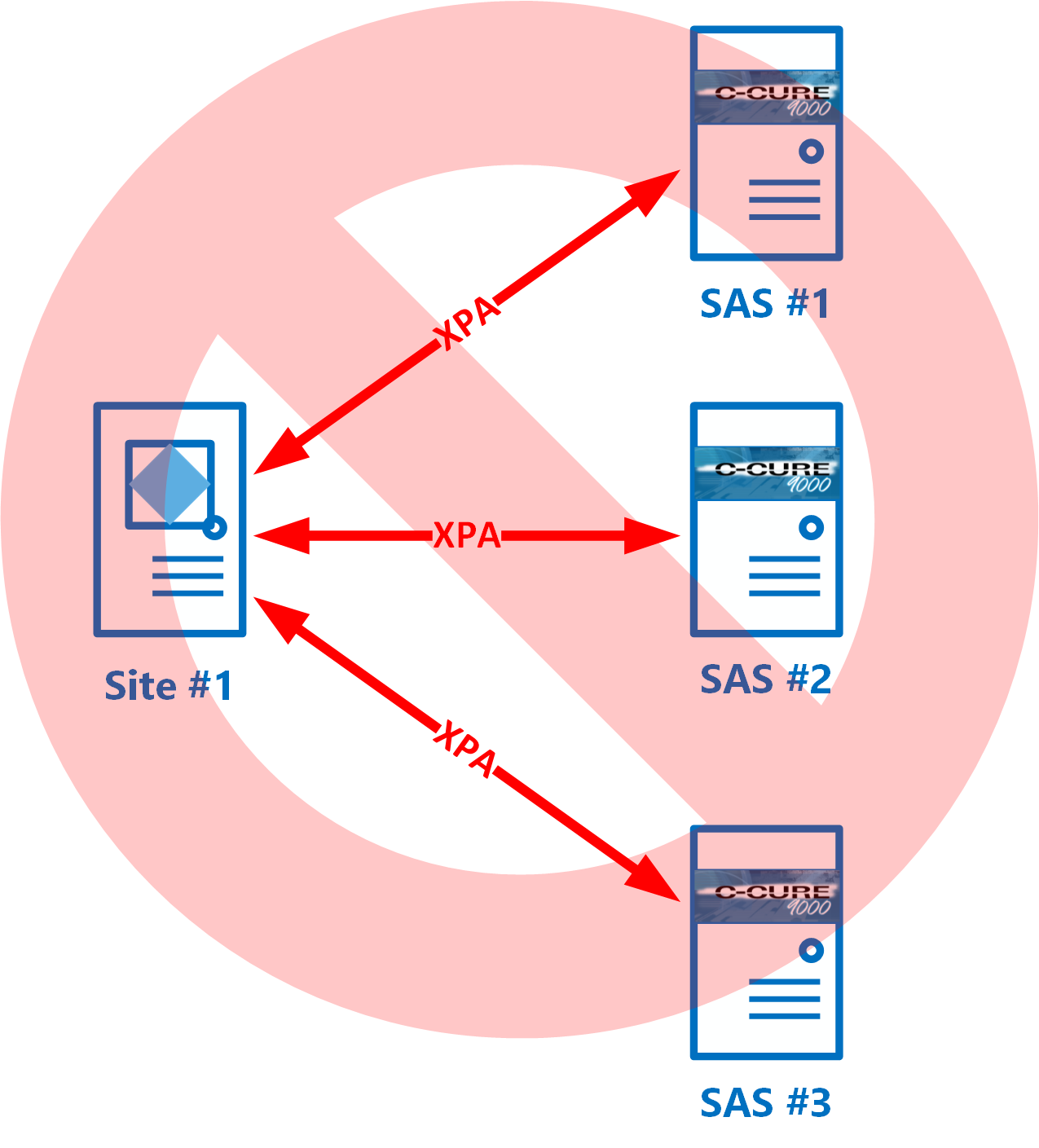

CCure 9000 Enterprise scenarios require that each CCure 9000 Satellite Application Server (SAS) installation has a maximum of one corresponding Federated XProtect site that connects to it. Each XProtect site, for performance reasons, should never have more than one CCure 9000 Satellite Application Server (SAS) connected. CCure 9000 Enterprise scenarios also require that no connection is directly made to a Master Application Server (MAS).
MAS-DIRECT NOT SUPPORTED
ONE-TO-MANY NOT SUPPORTED
