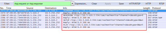

You can try to verify that the Universal driver uses the correct URL by looking at the RTSP requests in Wireshark (https://www.wireshark.org/).
Describe, setup, and play RTSP requests in Wireshark
You should see a DESCRIBE, SETUP and PLAY request using the URL specified in the settings. You can try to play this same exact URL in VLC (see 3.1 Testing with VideoLan Player (VLC))
