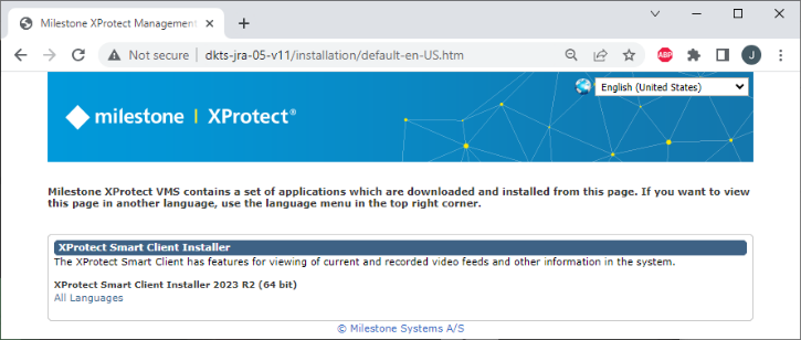

Client download page (does not require user authentication):
http://[enter-management-server-address]/installation/

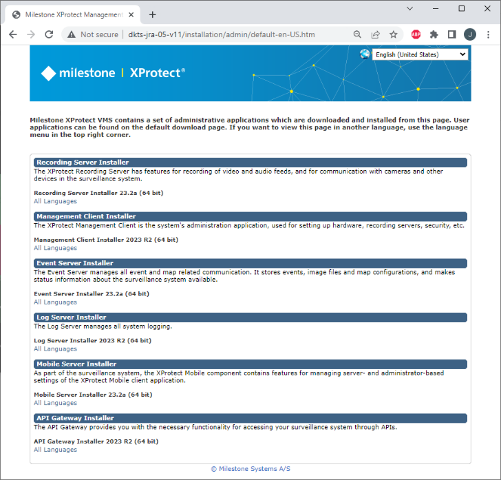

Server component download page (may require user authentication):
http://[enter-management-server-address]/installation/admin
