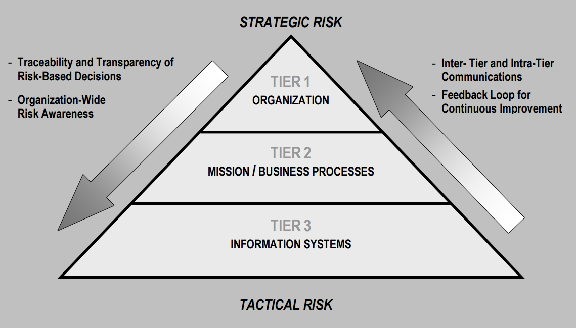

  • Risk management at a business level, taking strategic and tactical considerations into account.

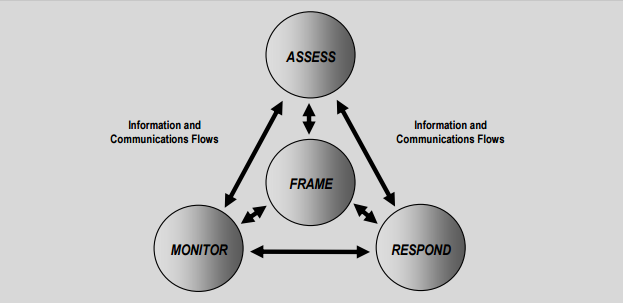

High-level view of risk management (SP 800-39, page 8 (https://csrc.nist.gov/publications/detail/sp/800-39/final))
The process is interactive, and responses and their outcomes are iterative. Security threats, risks, responses and results are dynamic and adapt, and as a result so must a security plan.

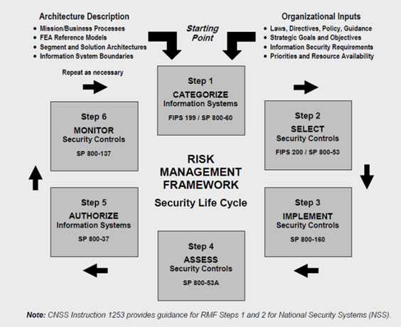

This diagram shows how a risk management framework considers IT systems, business processes, and the organization as a whole to find a balance for the security plan.
Balancing security and business goals (SP 800-39, page 9 (https://csrc.nist.gov/publications/detail/sp/800-39/final))
When hardening a system, you balance the impact on business productivity and usability for the sake of security, and vice versa, in the context of the services you deliver. Security guidance is not isolated from other business and IT activities.

Example of a risk management framework (SP 800-53 Rev 5, page 8 (https://csrc.nist.gov/publications/detail/sp/800-53/rev-5/final))
To document its risk management framework, NIST produced multiple special publications. It includes the following components:
  1. Categorization (identification of risk level)
  2. Selection of security and privacy controls
  3. Implementation
  4. Assessment of the effectiveness of security controls
  5. Creating an improved system security profile, and what’s called an Authority to Operate (ATO)
  6. Monitoring and evaluating through iterations
The risk management framework helps put a security plan and guidance in a security context.
