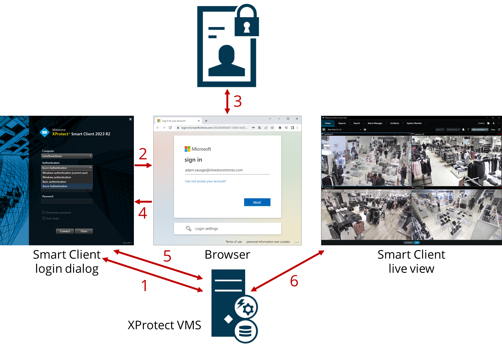

Login and authentication overview
When the Identity Provider and the XProtect VMS integration have been configured, the high-level login and authentication flow will look like this.
When the XProtect VMS address has been entered in the VMS client’s login dialog, the authentication options are retrieved from the XProtect VMS and listed in the login dialog
Choosing the external IDP option and clicking ‘Connect’, opens a browser window that displays the external IDP’s login page
Entering the username and password authenticates the user with the external IDP
After successful authentication, an OAuth token is transferred from the browser to the VMS client
Using the external IDP’s OAuth token, the VMS client authenticates the user in the VMS, which then returns a VMS security token and the configuration for the user
The VMS client is now started and provides access to the VMS resources that the user has permissions for
