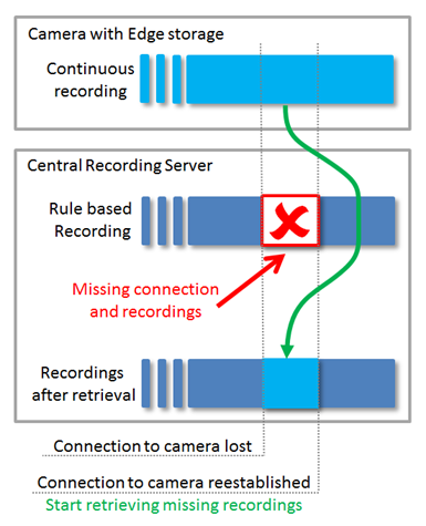

A diagram of a recording process Description automatically generated
Edge Storage retrieval illustration – system or network failure
The camera records to its Edge Storage, either continuously or based on the camera’s motion detection, schedule, or external events.
When the VMS detects that recordings are missing for a period due to a failure or missing connection to the camera, the recording server retrieves the recordings from the camera’s Edge Storage once the failure is resolved or the connection restored.
