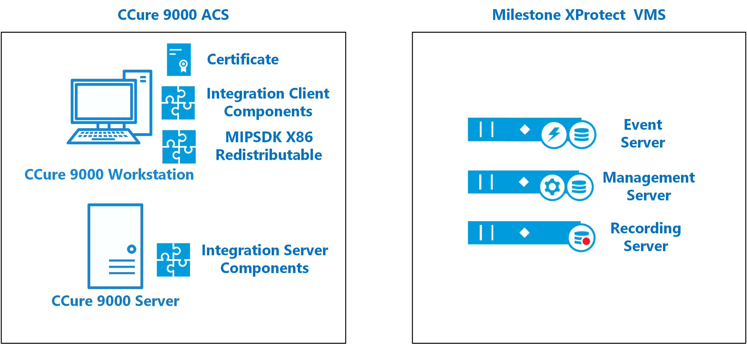

Single system installations, where Milestone XProtect consists of a single Management Server and a single Recording Server, and the CCure 9000 system consists of a single CCure 9000 Server should have an architecture similar to the diagram below.

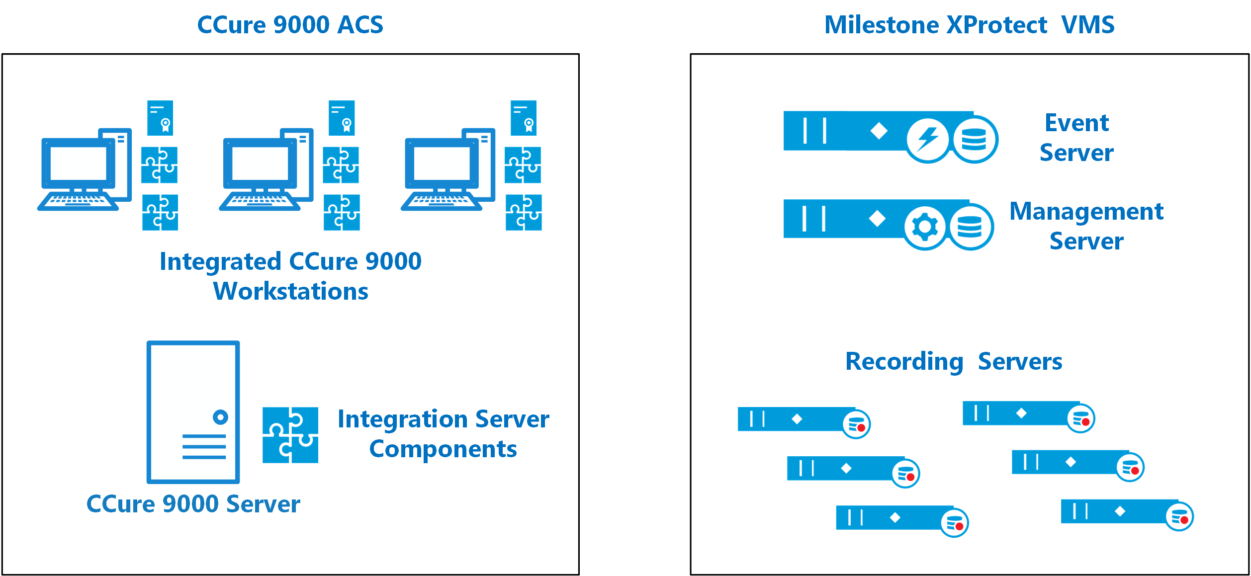

As systems scale in size, the two most important components in this integration are CCure 9000 workstations, and Milestone XProtect Recording Servers. For each CCure 9000 workstation added to the system, it will need all three of the components listed above, the certificate, the integration client components, and the MIPSDK X86 Redistributable. You must configure each Milestone XProtect Recording Server individually.

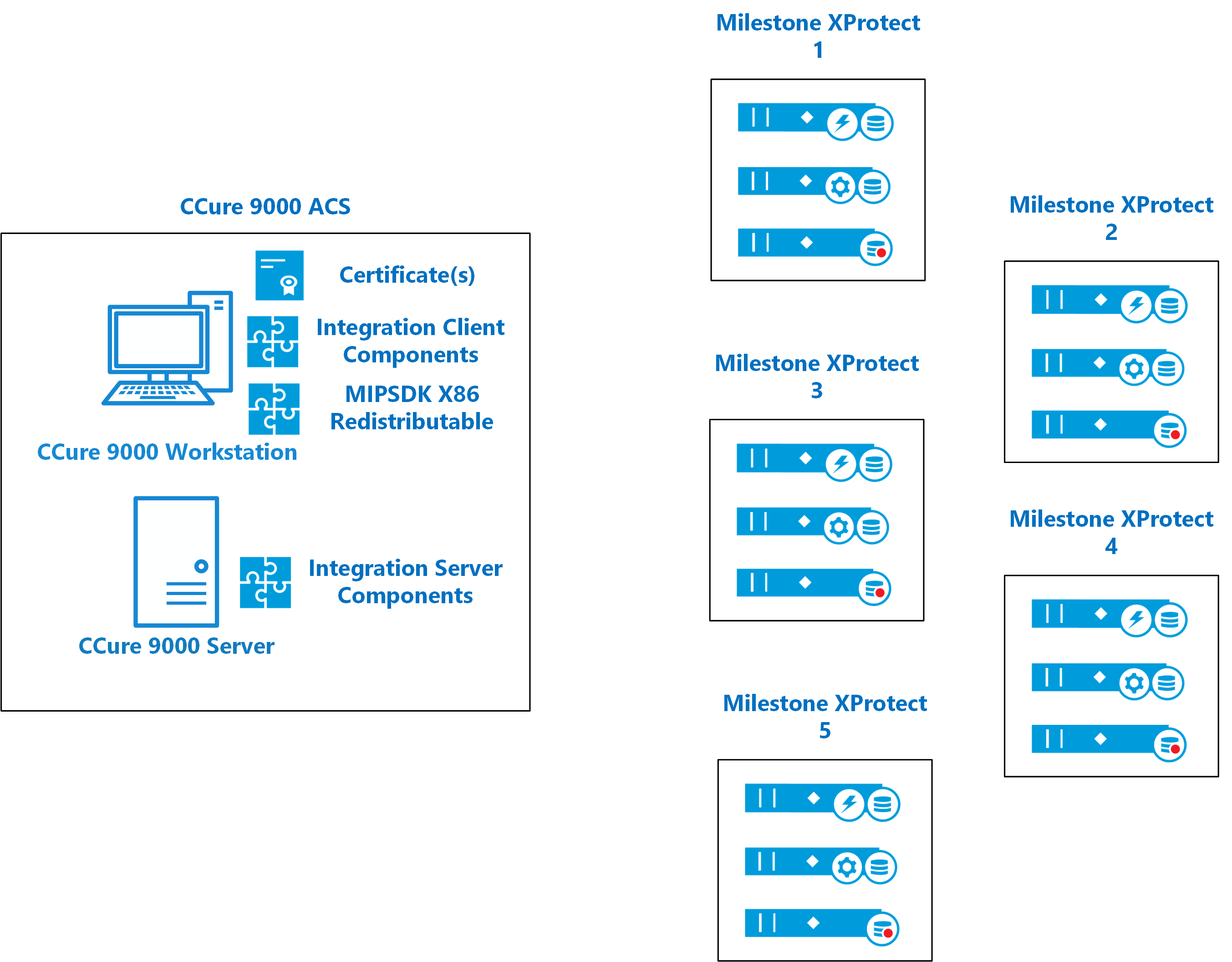

Scaling the number of cameras and Recording Servers can also include adding more Management Servers and Event Servers.The primary complication in this particular scenario is the requirement for a specific certificate on each CCure 9000 workstation that matches each individual XProtect VMS system.
Many other architectural options are available. Please consult Milestone Systems if your desired option is not listed.
