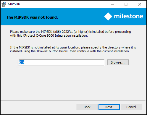

Important
The default installation location for the MIP SDK redistributable software components is:
C:\Program Files (x86)\Milestone\MIPSDK
If your installation requires a different location for these components, please contact Milestone Technical Support for assistance with the installation. When the MIP SDK components are installed in a different directory, the CCure 9000 Video Push integration software installation wizard detects the absence of the components at the default location and requires user input specifying the alternate directory before the installation continues.
