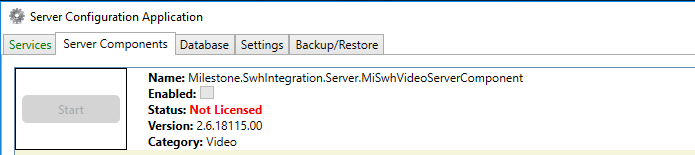

Even if you are required to install the server components of the integration on the MAS, there is no requirement to have a license to run the server components on the MAS. The CCure Server Configuration Application will display that the MiSwhVideoServerComponent is not licensed. However, this should not be a cause of concern, because while you must install the component, it doesn't need to run on a MAS.

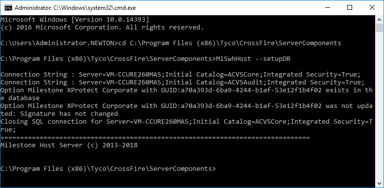

For the integration to work correctly on the MAS, you must make some changes to its database. To prepare the MAS database for the integration, open a Windows command prompt at the following path, then run the following command:
Path:
C:\Program Files (x86)\Tyco\CrossFire\ServerComponentsCommand:
MiSwhHost --setupDB
Note
When you run this command, make sure that the currently logged Windows user has access to the MAS database.
Close and re-open the CCure Server Configuration Application.
The Status column under the Database tab should now show VALID, in green, next to the Milestone.SwhIntegration.Common.MiSwhVideoObjects item.
