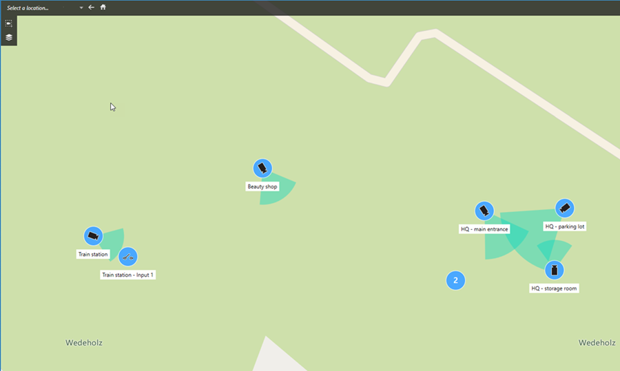

How devices appear on a smart map change based on how close they are to each other and how much you zoom in or out. Their appearance also depend on the number of devices you've selected.
Devices near each other relative to the zoom level
When cameras and other devices are close to each other, and you zoom out, the devices are grouped in clusters and displayed visually as circular icons. The cluster icon includes information about the number of devices inside that cluster.
A cluster of devices on a smart map.
Devices far from each other relative to the zoom level
When you zoom in, for example, by double-clicking the cluster, you can see the individual devices and any sub-clusters.
Multiple clusters on a smart map.
Information shared by the cluster icon
If a cluster contains different types of devices, for example, cameras, input devices, and microphones, the cluster icon shows the number of devices. If a cluster contains only one type of device, the cluster shows both the type of device and the number of devices.
Two clusters, with one containing a camera icon.
Click the cluster icon to get an overview of the different types of devices in that cluster.
Overview of a cluster showing device types and the number of devices for each type.
