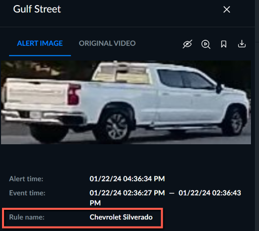

Best Practices
It is recommended to only select one make per rule and to add the name of the make and model in the name of the rule (as shown in the image below). This is because currently the Make & Model information is not displayed for each alert received.

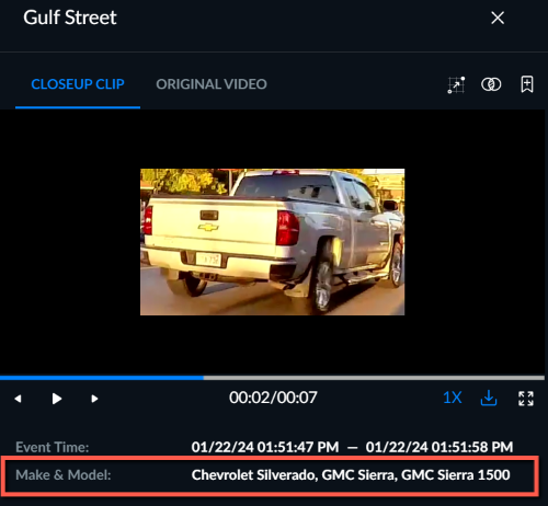

REVIEW Module
When you look at an object, you’ll see there all the possible make and models for this object with the most probably match listed first. The filter will return all chosen makes and models that passed the threshold (normal, strict, loose) in the order of probability.

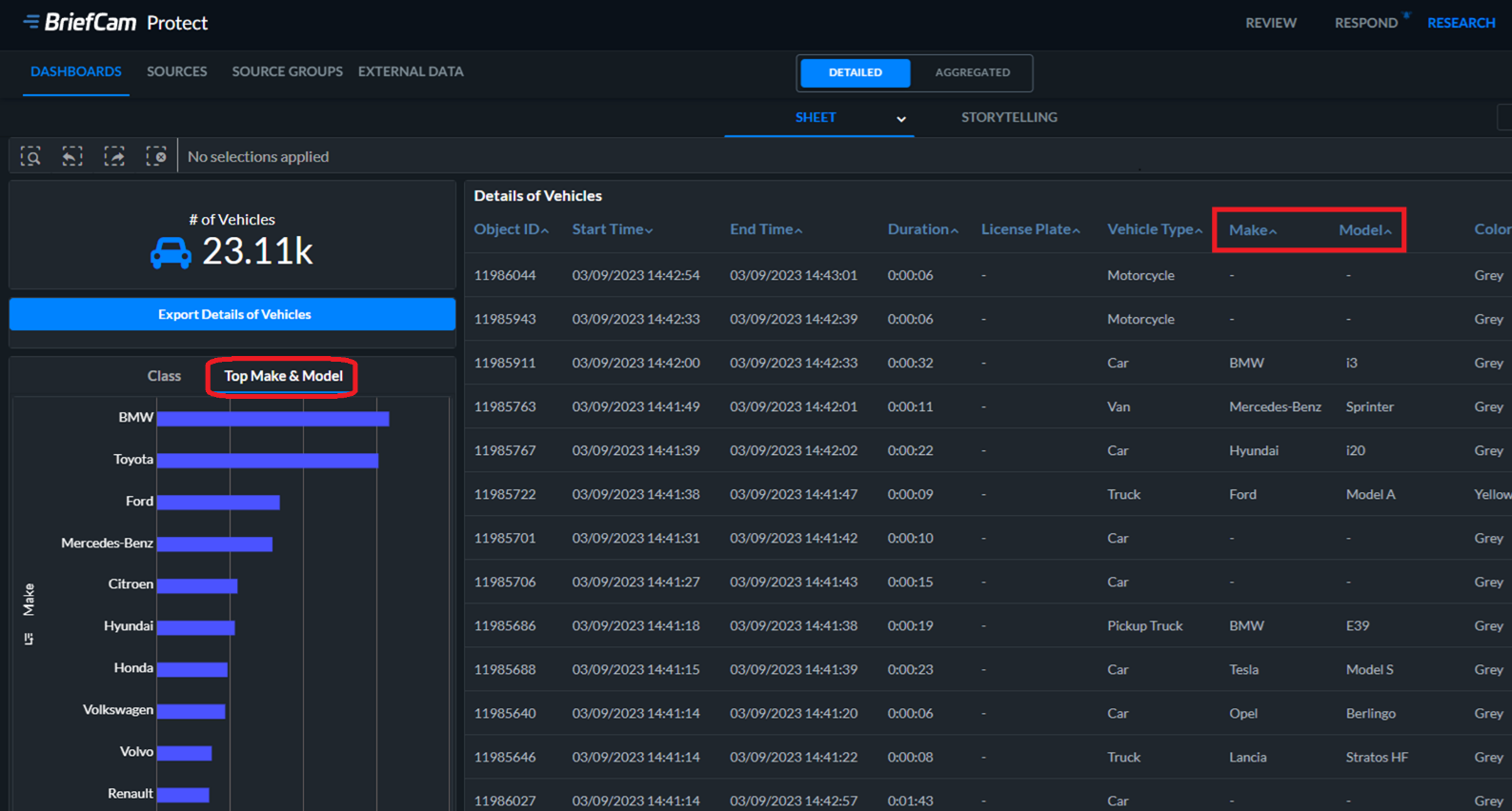

RESEARCH Module
In the RESEARCH module, information about the make and models appears in three of the built-in detailed dashboards:
  • Vehicle Details
  • Traffic Violations
  • Intersection Analysis
In each of the dashboards, you’ll see a chart with the 10 top makes and models. You can click on any of the makes to drill-down to the models for that make. In the Vehicle Details dashboard, you’ll also see a Make column and a Model column.
If the make and model information is not presented, it means that the model did not have enough confidence for it to be logged (or that only the make and model information above a certain threshold is presented).

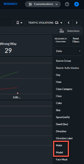

There are two dimensions, one for Make and one for Model, that you can use in your dashboards. In addition, in all dashboards, using the Filters pane you can filter by Make and Model.

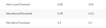

Tolerance Levels
When using the Tolerance levels, the three confidence levels can be adjusted using the following three environment settings:
  • Mmr.LooseThreshold
  • Mmr.NormalThreshold
  • Mmr.StrictThreshold
