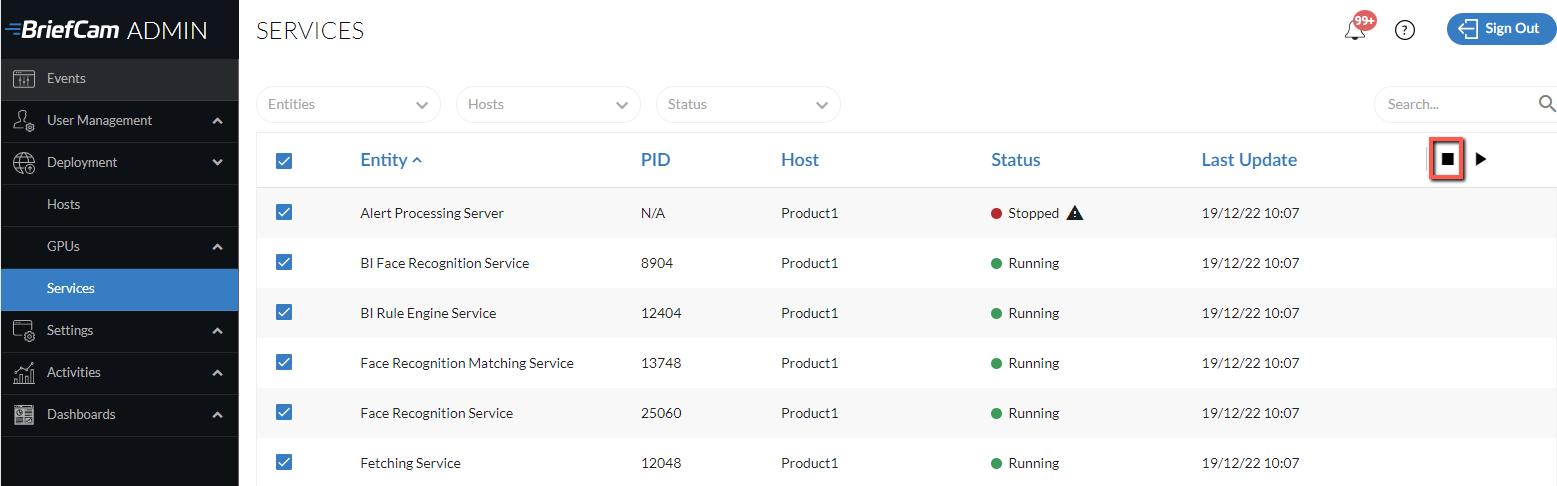

  3. Launch the BriefCam Administrator Console and stop the BriefCam services.

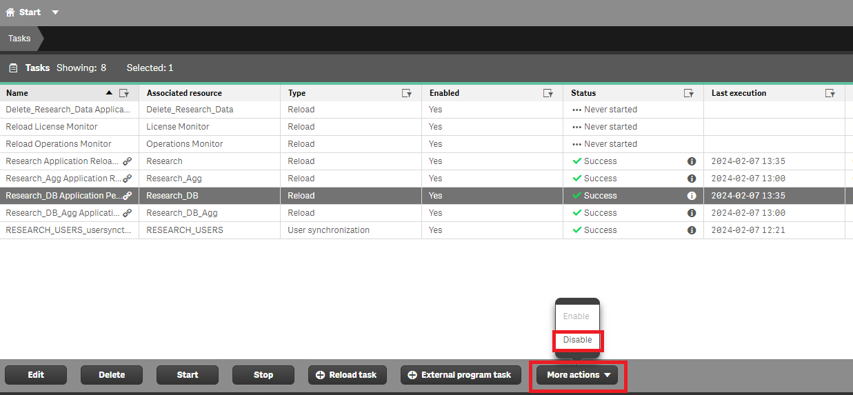

      • From the Tasks tab, disable the RESEARCH_DB and RESEARCH_DB _AGG tasks.

      • From the Tasks tab, enable the RESEARCH_DB and RESEARCH_DB _AGG tasks.

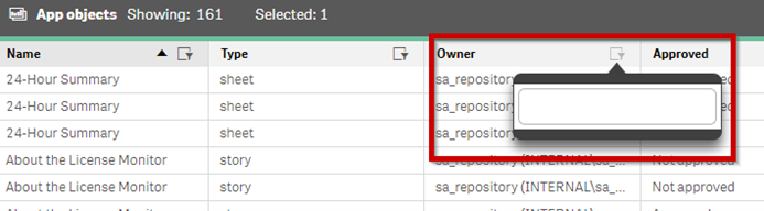

  15. If you are using the Milestone Embedded plugin and there are users with customized dashboards, you need to migrate the dashboards from the old user name to the new user name as follows:

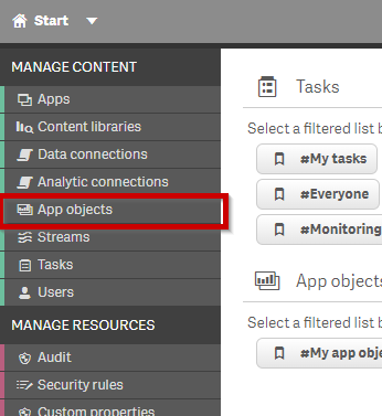

    1. Open Chrome as bcuser and navigate to QMC (https://hostname/qmc).
    2. Go to App objects.
    3. From the Owner column, click on the filter icon and select the old user.

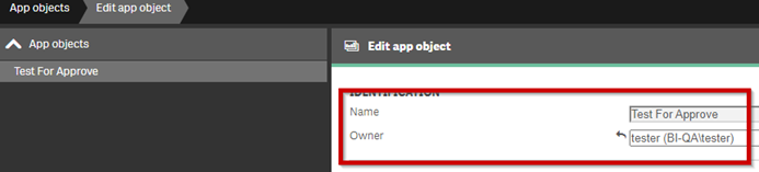

    4. The table will display all the sheets that were created by the old user. Double-click on each row in the table.

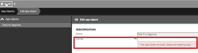

    5. Using the backspace, remove the value in the Owner field.
    6. Search and select the new user. For example, see the image below.
    7. Click Apply.
    8. Repeat the steps above for each sheet.

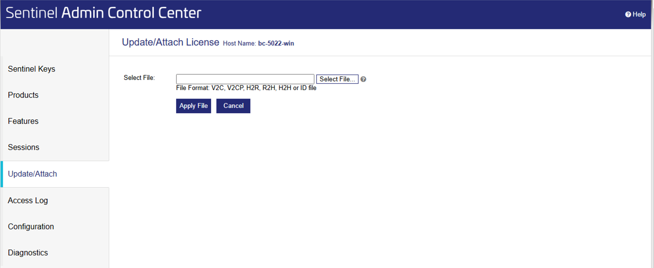

  16. Upgrade the license as follows:

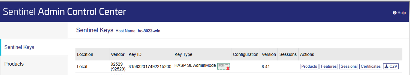

    1. Open the Chrome/Edge browser and go to . http://localhost:1947.
    2. Click on the Sentinel Keys option.
    3. From the Actions column, click C2V.
    4. Log into the BriefCam Portal at https://www.briefcam.com/support/ and open a ticket. You’ll attach the C2V file and request a V2C file with the new features.
    5. The BriefCam Customer Success team will email you the requested V2C (vendor to client) file.
    6. Open the Chrome/Edge browser and go to to http://localhost:1947.
    7. Click the Update/Attach option.
    8. Click the Select File button and select the V2C file that you received from BriefCam.
    9. Click the Apply File button.

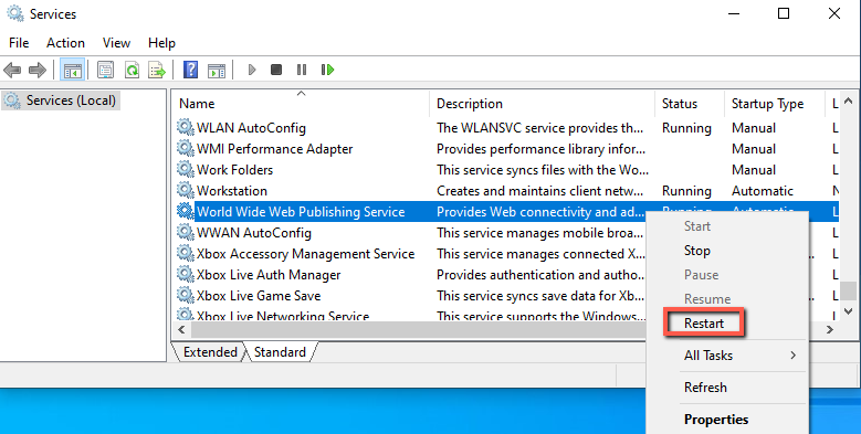

  20. Restart the IIS services on the machine where the BriefCam Web Services are installed (by opening the Windows Services, right-clicking on the World Wide Web Publishing Service and clicking Restart).
