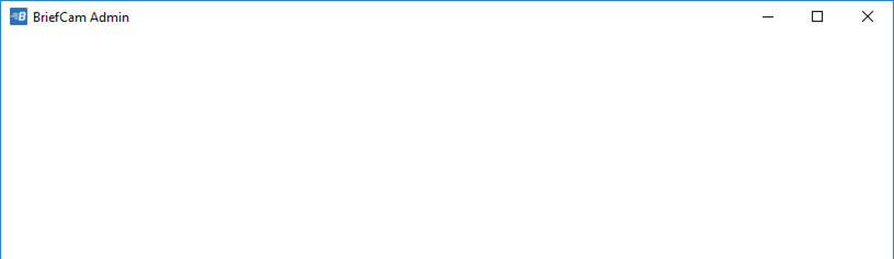

Sometimes a .NET app doesn’t load properly and instead it displays a blank window rather than the full graphic view (see sample below) and stops responding. This is called a Blank WPF window.
This is related to the graphic HW acceleration settings, or the current driver installed.

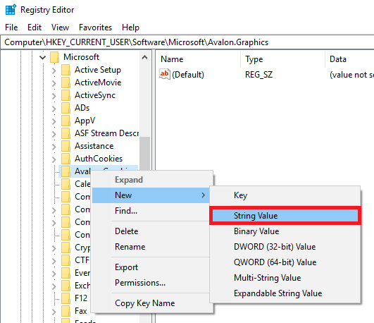

    4. If the word key does not exist, create one by right-clicking and choosing String Value.

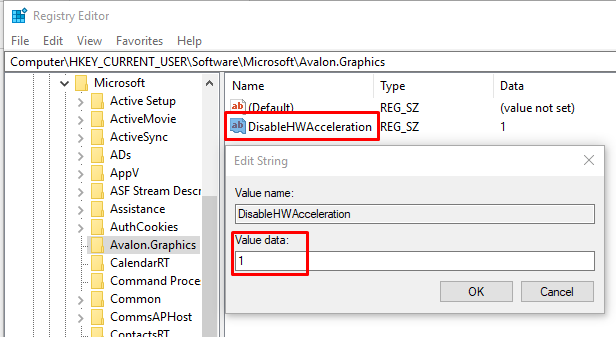

    5. Name the new key DisableHWAcceleration.
    6. Set the value to 1.
