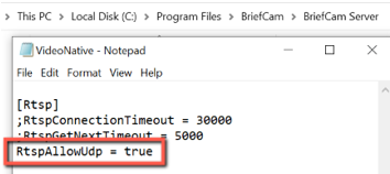

  1. In the VideoNative.ini file (located by default at: C:\Program Files\BriefCam\BriefCam Server), set the AllowUdp parameter to true. This set the RTSP streaming transport protocol to UDP instead of TCP.

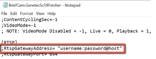

  2. It is also recommended to move the Genetec gateway to a separate server and add the RTSP’s IP and credentials to the plugin configuration file in the following format: RtspGatewayAddress= "username:password@host" where host is the media gateway's IP address. Remember also to uncomment the row in the configuration file (by deleting the semicolon).
