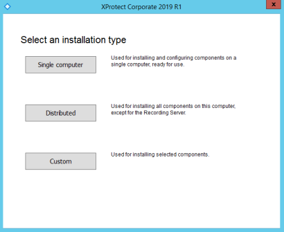

This means that when you install the XProtect VMS, do not use the Single computer option in the installer, because this automatically installs the Mobilserver.
Instead, install the XProtect VMS system with either the Distributed or Custom options. These do not install the Mobilserver.
After the XProtect VMS has been installed, the download page on the Konfigurationsserver will list the additional XProtect DLNA Server and Mobilserver components. Do not install these servers.
