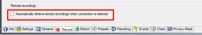

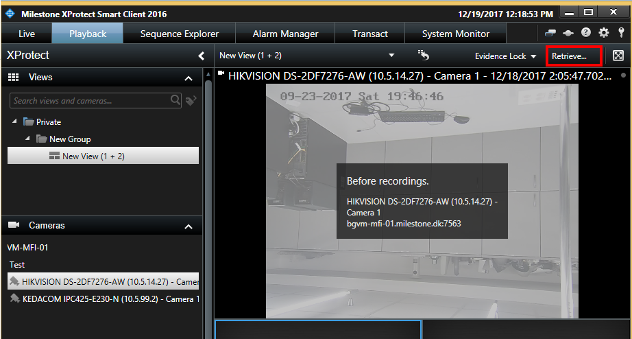

While the device is added in the Management Application, the driver will retrieve all services that the device supports. If all the mentioned services are implemented, the Edge Storage functionality will be available in XProtect. The automatic retrieving in Management Application will be available as well as the “Retrieve” button in the Smart Client.
  • Management Application
  • Smart Client
If one of these does not show in the Management Application or the Smart Client, then this means that Edge Storage is not available and therefore some of the important services are not implemented by the device firmware.
