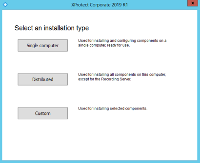

This means that when you install the XProtect VMS, do not use the Single computer option in the installer, because this automatically installs the モバイルサーバー.
Instead, install the XProtect VMS system with either the Distributed or Custom options. These do not install the モバイルサーバー.
