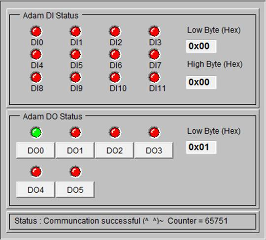

The Test button has been pressed to show pin 0/error code 0x01.

When you click the Test button in System Watch, it raises pin 0 (and only pin 0) for a short while on the ADAM box (as seen in the screenshot above).
