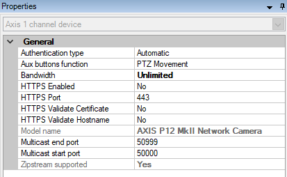

Axis drivers
Do the following:
- Set HTTPS Enabled to Yes.
- Set HTTPS Validate Certificate to Yes.
- Set HTTPS Validate Hostname to Yes.

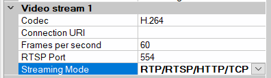

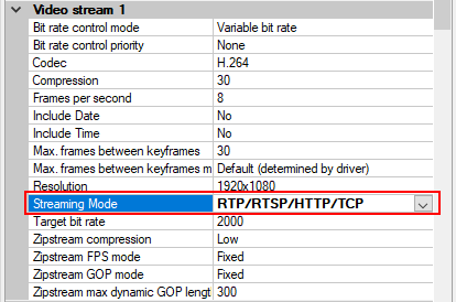

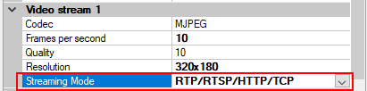

- For every enabled media channel and media stream, set Streaming Mode to RTP/RTSP/HTTP/TCP.

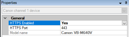

Canon drivers
- Set the HTTPS Enabled to Yes.

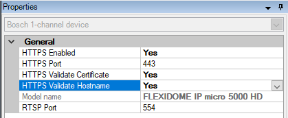

Bosch drivers
Do the following:

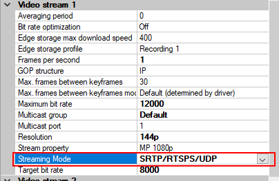

- For every enabled media channel and media stream, set Streaming Mode to one of the following:
- RTP/RTSP/HTTP/TCP
- SRTP/RTSPS/UDP
- SRT/RTSPS/UDP multicast

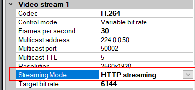

Hanwha drivers

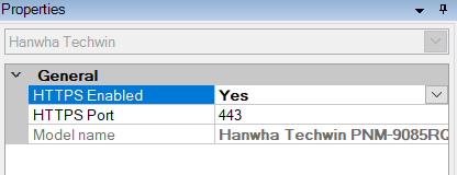

- For every enabled media channel and media stream, set Streaming Mode to HTTP streaming.

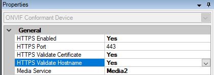

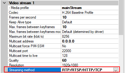

- For every enabled media channel and media stream, set Streaming method to RTP/RTSP/HTTP/TCP.

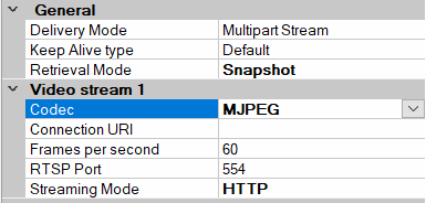

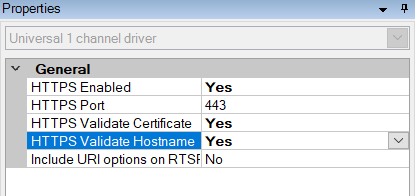

Universal drivers
Do the following:
- For every enabled media channel and media stream, set Streaming Mode to either RTP/RTSP/HTTP/TCP or HTTP, depending whether streaming or snapshot retrieval mode is used.
