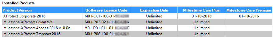

Installed Products
Lists the following information about all your installed base licenses for VMS XProtect and add-on products that share the same software license file:
  • Products and versions
  • The products' software license code (SLC)
  • The expiration date of your SLC. Typically, unlimited
  • The expiration date of your Milestone Care Plus subscription
  • The expiration date of your Milestone Care Premium subscription
Some licenses, such as XProtect Essential+, are installed with the automatic license activation enabled, and it is not possible to disable this setting.

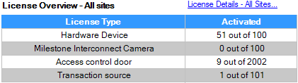

License Overview - All sites
Lists the number of activated hardware device licenses or other licenses in your software license file and the total number of available licenses on your system. Here you can easily see if you can still grow your system without purchasing additional licenses.
For a detailed overview of the status of your licenses activated on other sites, click the License Details - All sites link. See the License Details - Current site section below for the available information.
If you have licenses for add-on products, you can see additional details about these under the add-on product specific nodes in the Site Navigation Pane.
