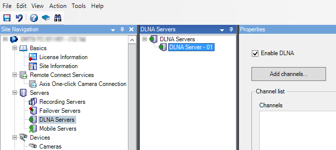

  1. Open the Management Client.
  2. Expand Servers, select DLNA Servers, and then select the DLNA server you just added.
  3. To rename the server right-click the DLNA Server and select Rename. The name you enter is the name that DLNA devices discover during a scan for media available content.
  4. On the Properties tab, the Enable DLNA check box is selected by default. Clear the check box if you want to disable DLNA availability.
Add channels

To select the cameras available for DLNA devices, follow these steps:
  1. Click the Add channels button.
  2. Select a channel type.
