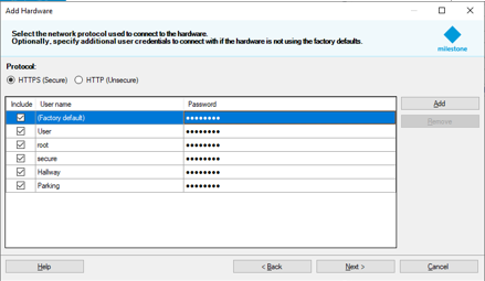

Connect devices: background
If you want to operate VMS XProtect in a FIPS compliant mode, you must make sure that the drivers, and hence the communication to the devices, also adhere to FIPS compliance.
The VMS Milestone XProtect device drivers can be FIPS 140-2 compliant because they can be configured and operate so that they use only FIPS 140-2 compliant algorithm instances. Only specific drivers in a specific configuration are FIPS 140-2 compliant. In this specific FIPS 140-2 configuration the driver will be able to communicate with devices in a compliant way. The devices must fulfill several requirements in order to be able to accept this communication. In addition, the FIPS Group Policy flag must be enabled in Windows on the server where the recording server is installed. When the FIPS Group Policy flag is enabled, the FIPS 140-2 capable drivers will operate in compliant mode and will not use non-approved cryptographic primitives. The drivers will use the algorithms used only for secured channels of communication.
Device connectivity requirements
VMS XProtect is guaranteed and can enforce FIPS 140-2 compliant mode of operation if the following criteria are met:
- Devices use only drivers from the list (Supported drivers) to connect to VMS XProtect
This list shows drivers that can assure and enforce compliance.
- Devices use device pack version 11.1 or higher
Drivers from the legacy driver device packs cannot guarantee a FIPS 140-2 compliant connection.
- Devices are connected over HTTPS and on either Secure Real-Time Transport Protocol (SRTP) or Real Time Streaming Protocol (RTSP) over HTTPS for the video stream
Driver modules cannot guarantee FIPS 140-2 compliance of a connection over HTTP. The connection may be compliant, but there is no guarantee that it is in fact compliant.
- The computer that is running the recording server must have the FIPS Group Policy flag enabled in Windows

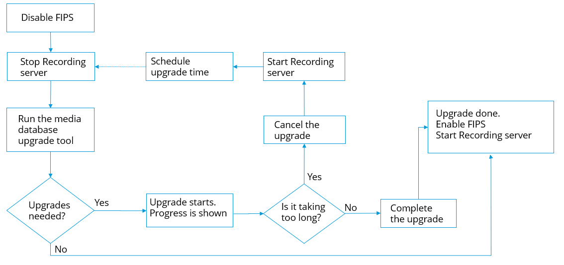

Media database upgrade: VMS XProtect 2017 R2 to VMS XProtect 2019 R3
If you are running a version of VMS XProtect between VMS XProtect 2017 R2 and VMS XProtect 2019 R3 and if at any point in time encryption has been enabled in the media database, in order to access these recordings you must do one of the following options.
Both options require the use of the media conversion tool. The recording server must be stopped while the media conversion tool is running, and there are no recordings being made while the tool is running. See What is the media conversion tool? for more information.
- Option 1
Use this option to be able to operate in a FIPS environment right away, and if you have a long retention time. The time required to run the media conversion tool could be significant.
- Upgrade VMS XProtect to 2020 R3.
- With FIPS disabled on the Windows operating system, run the media conversion tool that is provided by Milestone support.
- Enable the FIPS Group Policy flag on the Windows operating system.
- Option 2
Use this option if operating in a FIPS environment can wait, if you have a short retention time, and if you are running the media conversion tool on less data.
- Run the VMS XProtect through the retention time without enabling FIPS on the Windows operating system.
- Run the media conversion tool to ensure that all the data is converted to be FIPS compliant.
The media conversion tool is a stand-alone PowerShell script, that is delivered in source. It is not part of any installation.
It is to be distributed to customers only through Milestone support.
It can convert all storage in bulk, or it can be run on a specific storage.
Progress indicators show how far the tool has gotten.
If the conversion takes too long, you can cancel the job and continue without FIPS enabled.
The media conversion tool converts encrypted credentials inside existing media table files to the newest format that is FIPS compatible.
The media conversion tool does not change the encryption of the video data itself. If the video data is encrypted with a non-compliant algorithm (DES), the updated tables will load, but video will be inaccessible in FIPS compliant mode.
The media conversion tool converts and checks if all tables are using FIPS compliant algorithms.
Approved tables will be marked to eliminate them from being checked by media conversion tool again.
After running the media conversion tool, the VMS XProtect 2020 R3 will be able to load tables in FIPS compliant mode.
Media conversion tool workflow
Media database upgrade: VMS XProtect 2020 R1 or VMS XProtect 2020 R2
If you are running VMS XProtect version 2020 R1 or VMS XProtect 2020 R2, media data that is recorded with one of these versions will be automatically re-encrypted with FIPS 140-2 compliant algorithms during the recording server upgrade.

Encrypt hardware detection passwords
The hardware detection passwords must be updated after you upgrade to VMS XProtect 2020 R3.
The encryption of the hardware detection passwords is not updated during upgrade from earlier version of VMS XProtect. But, these passwords cannot be read if the FIPS Group Policy flag is enabled in Windows.
You must trigger a conversion of these passwords before you enable FIPS. Do the following:
- Make sure the FIPS Group Policy flag is disabled in Windows.
- In XProtect Management Client, open the Add Hardware wizard.
- Select the detection method to open the hardware detection page.
This triggers the re-encryption of the hardware detection passwords with FIPS-compliant algorithms.
The credentials are now encrypted with FIPS-compliant algorithms.
