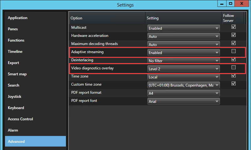

Check adaptive streaming settings
  1. Go to Settings > Advanced > Adaptive streaming.
  2. There are two settings for adaptive streaming: Disabled and Enabled.
    Select Enabled.
    Adaptive streaming settings in XProtect Smart Client.
  3. Go to Video diagnostics overlay.
  4. To make the current video resolution of the stream visible, select Level 2.
  5. This setting applies to all view items. The default setting is Hide.
  6. The video diagnostics overlay should now be Enabled.
  7. Try to resize the view window from small to large, large to small and check if the Video resolution value changes.
