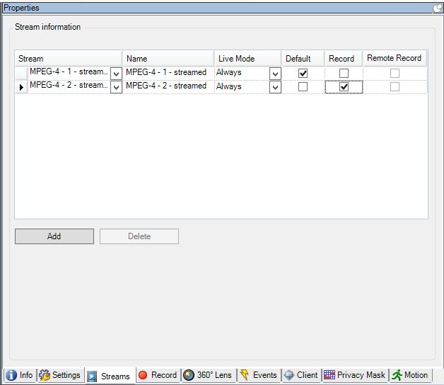

Add a stream
  1. On the Streams tab, click Add. This adds a second stream to the list.
  2. In the Name column, edit the name of the stream. The name appears in XProtect Smart Client.
  3. In the Live Mode column, select when live streaming is needed:
    • Always: the stream runs even if no XProtect Smart Client users request the stream
    • Never: the stream is off. Only use this for recording streams, for example, if you want recordings in high quality and need the bandwidth
    • When needed: the stream starts when a user of XProtect Smart Client requests for it
  4. In the Default column, select which stream is default.
  5. In the Record column, select the check box if you want to record this stream or leave it cleared if you only want to use it for live video.
  6. Click Save.
If you set a stream to Default or Record, the stream is always running independent of the Live Mode setting. Selecting When needed and Always have the same effect in the system and if you select Never, the stream is running, but cannot be viewed live.
If you do not want the streams to run at all unless someone is viewing live video, you can modify the Default Start Feed Rule to start on request with the predefined Live Client Feed Requested event.

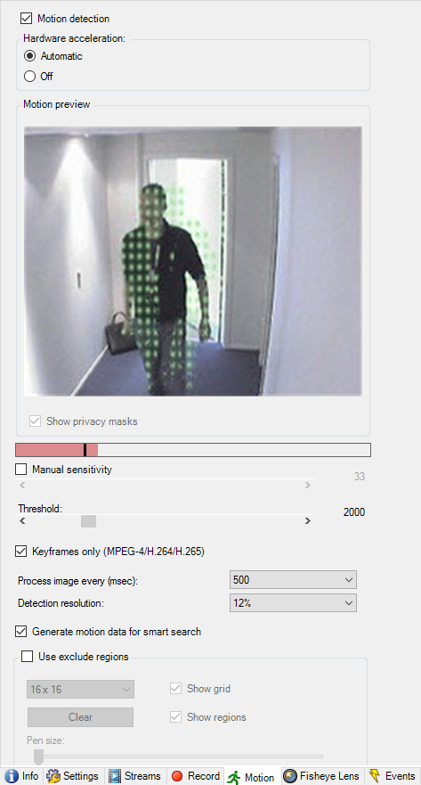

On the Motion tab, you can enable and configure motion detection for the selected camera. Motion detection configuration is a key element in your system: Your motion detection configuration determines when the system generates motion events and typically also when video is recorded.
Time spent on finding the best possible motion detection configuration for each camera helps you later avoid, for example, unnecessary recordings. Depending on the physical location of the camera, it may be a good idea to test motion detection settings under different physical conditions such as day/night and windy/calm weather.
Before you configure motion detection for a camera, Milestone recommends that you have configured the camera's image quality settings, for example resolution, video codec and stream settings on the Settings tab. If you later change image quality settings, you should always test any motion detection configuration afterwards.
If you have defined areas with permanent privacy masks on the Privacy masking (see Privacy masking tab (devices)) tab, you can choose to display the privacy masks on the Motion tab by selecting the Show privacy masks check box.
There is no motion detection within areas covered by permanent privacy masks.
You can configure all the settings for a group of cameras, but you would typically set the exclude regions per camera.
Enable and disable motion detection
You specify the default setting of motion detection for cameras on the Tools > Options > General tab.
To enable or disable motion detection afterwards for a camera:
  • Select or clear the Motion tab's Motion detection check box
When you disable motion detection for a camera, motion detection-related rules for the camera do not work.
Specify motion detection settings
You can specify settings related to the amount of changes required in a camera's view in order for the change to be regarded as motion. You can for example specify intervals between motion detection analysis and areas of a view in which motion should be ignored. You can also adjust the accuracy of the motion detection and thereby the load on system resources.
Hardware acceleration (explained)
Select Automatic to enable hardware accelerated video motion detection. This is the default setting when you add a camera. The recording server is now using GPU resources if they are available. This will reduce the CPU load during video motion analysis and improve the general performance of the recording server.
Hardware accelerated video motion detection uses GPU resources on:
  • Intel CPUs that support Intel Quick Sync
  • NVIDIA® display adapters connected to your recording server
The load balancing between the different resources is done automatically. In the System Monitor node you can verify if the current motion analysis load on the NVIDIA GPU resources is within the specified limits from the System Monitor Thresholds node. The NVIDIA GPU load indicators are:
  • NVIDIA decoding
  • NVIDIA memory
  • NVIDIA rendering
If the load is too high, you can add GPU resources to your recording server by installing multiple NVIDIA display adapters. Milestone does not recommend the use of Scalable Link Interface (SLI) configuration of your NVIDIA display adapters.
NVIDIA products have different compute capabilities. To verify that your NVIDIA product supports hardware acceleration for the codecs used in your Milestone XProtect system, look up the supported codecs for the compute capability version in the table below.
To find out the compute capability version for your NVIDIA product, visit the NVIDIA website (https://developer.nvidia.com/cuda-gpus/).
Compute capability
Architecture
H.264
H.265
3.x
Kepler
5.x
Maxwell
6.x
Pascal
7.x
Volta
To see if video motion detection is hardware accelerated for a specific camera, enable logging on the recoding server log file. Set level to Debug and diagnostics is logged to the DeviceHandling.log. The log follows the pattern:
[time] [274] DEBUG – [guid] [name] Configured decoding: Automatic: Actual decoding: Intel/NVIDIA
The OS version of the recording server and CPU generation may impact performance of hardware accelerated video motion detection. GPU memory allocation is often the bottleneck with older versions (typical limit is between 0.5 GB and 1.7 GB).
Systems based on Windows 10 / Server 2016 and 6th generation CPU (Skylake) or newer can allocate 50% of system memory to GPU and thereby removing or reducing this bottleneck.
6th generation Intel CPUs does provide hardware accelerated decoding of H.265, so the performance is comparable with H.264 for these versions of CPU.
Enable manual sensitivity
The sensitivity setting determines how much each pixel in the image must change before it is regarded as motion.
  1. Select the Motion tab's Manual Sensitivity check box.
  2. Drag the slider to the left for a higher sensitivity level, and to the right for a lower sensitivity level.
    The higher the sensitivity level, the less change is allowed in each pixel before it is regarded as motion.
    The lower the sensitivity level, the more change in each pixel is allowed before it is regarded as motion.
    Pixels in which motion is detected are highlighted in green in the preview image.
  3. Select a slider position in which only detections you consider motion are highlighted.
You can compare and set the exact sensitivity setting between cameras by the number in the right side of the slider.
Specify threshold
The motion detection threshold determines how many pixels in the image must change before it is regarded as motion.
  1. Drag the slider to the left for a higher motion level, and to the right for a lower motion level.
  2. Select a slider position in which only detections that you consider motion are detected.
The black vertical line in the motion indication bar shows the motion detection threshold: When detected motion is above the selected detection threshold level, the bar changes color from green to red, indicating a positive detection.
Motion indication bar: changes color from green to red when above the threshold, indicating a positive motion detection.
Select keyframes settings
Determines if motion detection is done on keyframes only instead of on the entire video stream. Only applies to MPEG-4/H.264/H.265.
Motion detection on keyframes reduces the amount of processing power used to carry out the analysis.
Select Keyframes only (MPEG-4/H.264/H.265) box to do motion detection on keyframes only.
Select image processing interval
You can select how often the system performs the motion detection analysis.
From the Process image every (msec) list:
  • Select the interval. For example, every 1000 milliseconds are once every second. Default value is every 500 milliseconds.
    The interval is applied if the actual frame rate is higher than the interval you set here.
Specify detection resolution
Lets you optimize motion detection performance by analyzing only a selected percentage of the image, for example 25%. By analyzing 25%, only every fourth pixel in the image is analyzed instead of all pixels.
Using optimized detection reduces the amount of processing power used to carry out the analysis, but also means a less accurate motion detection.
  • In the Detection resolution list, select the wanted detection resolution.
Generating motion data for smart search
With Generate motion data for smart search enabled, the system generates motion data for the images used for motion detection. For example, if you select motion detection on keyframes only, the motion data is also produced for keyframes only.
The extra motion data enables the client user, via the smart search function, to quickly search for relevant recordings based on motion in the selected area of the image. The system does not generate motion data within areas covered by permanent privacy masks, but only for areas with liftable privacy masks (see Privacy masking tab (devices)).
Motion detection threshold and exclude regions do not influence the generated motion data.
You specify the default setting of generating smart search data for cameras on the Tools > Options > General tab.
Specify exclude regions
You can exclude motion detection from specific areas of a camera view.
Areas with permanent privacy masks, are also excluded from motion detection. Select the Show privacy masks check box to display them.
Excluding motion detection from specific areas helps you avoid detection of irrelevant motion, for example if the camera covers an area where a tree is swaying in the wind or where cars regularly pass by in the background.
When you use exclude regions with PTZ cameras and you pan-tilt-zoom the camera, the excluded area does not move accordingly because the area is locked to the camera image, and not the object.
  1. To use exclude regions, select the Use exclude regions check box.
    A grid divides the preview image into selectable sections.
  2. To define exclude regions, drag the mouse pointer over the required areas in the preview image while you press the left mouse button. Right mouse button clears a grid section.
You can define as many exclude regions as needed. Excluded regions appear in blue:
The blue exclude areas only appear in the preview image on the Motion tab, not in any other preview images in the Management Client or access clients.

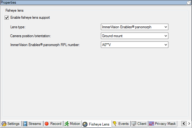

Fisheye lens tab (devices)
Fisheye Lens tab (explained)
The following devices have a Fisheye Lens tab:
  • Fixed cameras with a fisheye lens
On the Fisheye Lens tab, you can enable and configure fisheye lens support for the selected camera.
Enable and disable fisheye lens support
The fisheye lens support is disabled by default.
To enable or disable it, select or clear the Fisheye Lens tab's Enable fisheye lens support check box.
Specify fisheye lens settings
When you enable the fisheye lens support:
  1. Select the lens type.
  2. Specify the physical position/orientation of the camera from the Camera position/orientation list.
  3. Select a Registered Panomorph Lens (RPL) number from the ImmerVision Enables® panomorph RPL number list.
    This ensures the identification and correct configuration of the lens used with the camera. You usually find the RPL number on the lens itself or on the box it came in. For details of ImmerVision, panomorph lenses, and RPLs, see the Immervision website (https://www.immervisionenables.com/).

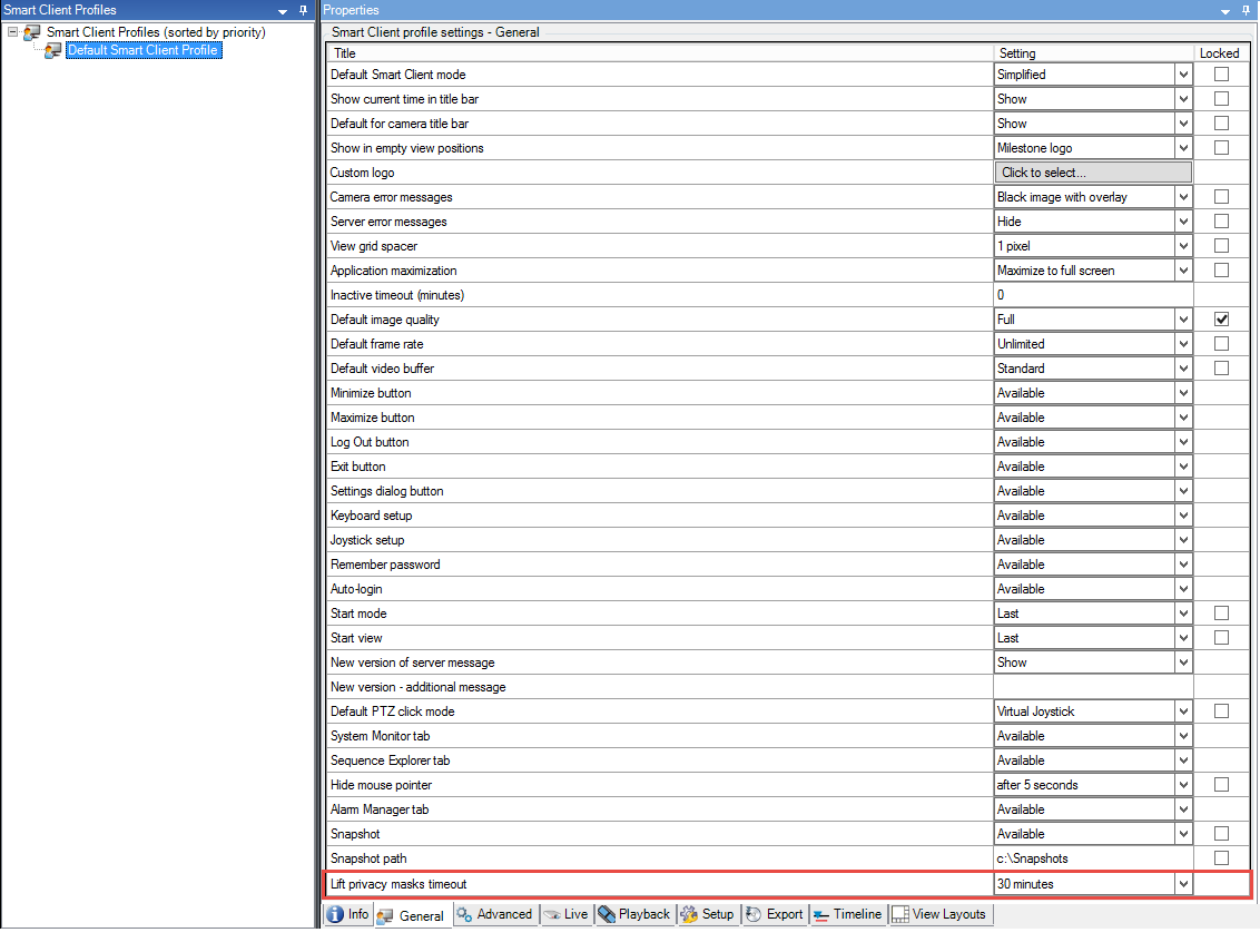

Change the timeout for lifted privacy masks
By default, privacy masks are lifted for 30 minutes in XProtect Smart Client and afterwards applied automatically, but you can change that.
When you change the timeout, remember to do it for the Smart Client profile associated with the role that has the permission to lift privacy masks.
To change the timeout:
  1. Under Smart Client Profiles, select the relevant Smart Client profile.
  2. On the General tab, locate Lift privacy masks timeout.
  3. Select between the values:
    • 2 minutes
    • 10 minutes
    • 30 minutes
    • 1 hour
    • 2 hours
    • Until logged out
  4. Click Save.

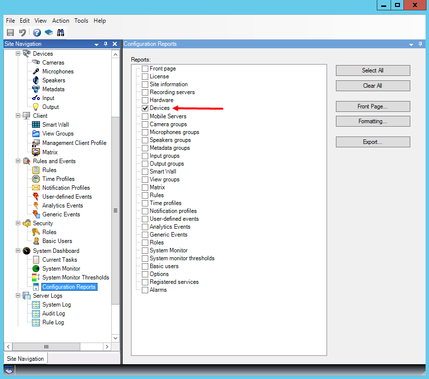

Create a report of your privacy masking configuration
The devices report include information about your cameras' current privacy masking settings.
To configure a report:
  1. Under Configuration Reports, select the Devices report.
  2. If you want to modify the report, you can change the front page and the formatting.
  3. Click Export, and the system creates the report as a PDF file.
For more information about reports, see Configuration reports (explained).
