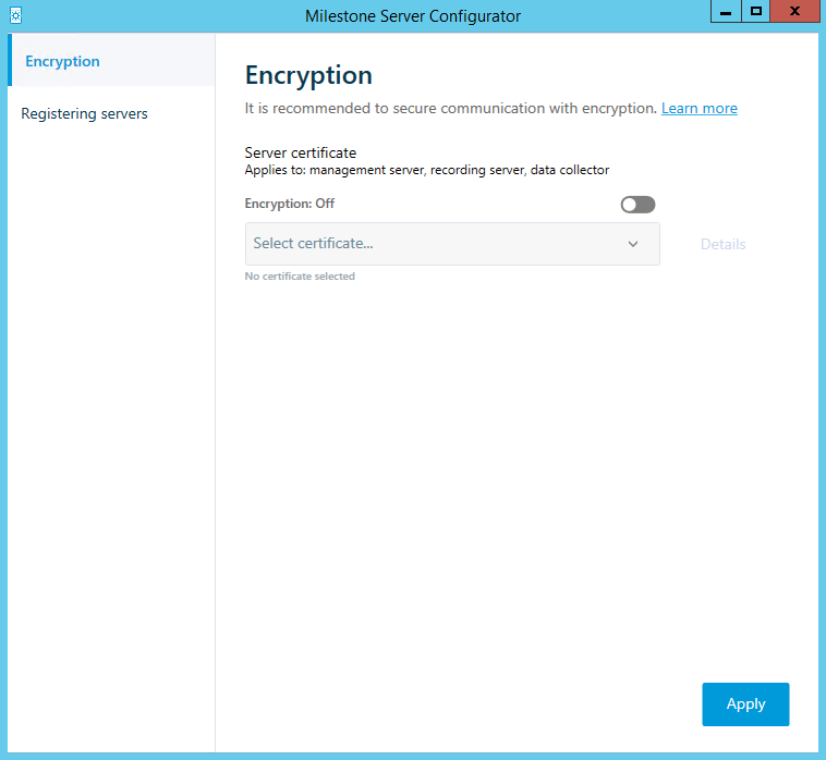

On the computer that runs the management server, right-click the Management Server Manager icon in the notification area and select Serverkonfigurator.
The Serverkonfigurator window appears. The options in this window depend on what servers are installed on the computer.
Under Server certificate, turn on encryption and select the certificate to encrypt communication between the recording server, management server and data collector server.
When you select a certificate, a list appears with unique subject names of certificates installed on the local computer in the Windows Certificate Store that has a private key.
Select Details to view Windows Certificate Store information about the selected certificate.
- Click Apply.

On each computer that runs a recording server or remote server with a data collector, open the Serverkonfiguratorfrom the Windows startup menu.
In the Serverkonfigurator, under Server certificate, turn on encryption and select the certificate to encrypt communication between the recording server, management server and data collector server.
The recording server service user has been given access to the private key. It is required that this certificate is trusted on all clients.
- Click Apply.

On each computer that runs a recording server or remote server with a data collector, open the Serverkonfigurator from the Windows startup menu.
In the Serverkonfigurator, under Streaming media certificate, turn on encryption and select the certificate to encrypt communication between the clients and servers that retrieve data streams from the recording server.
- Click Apply.
