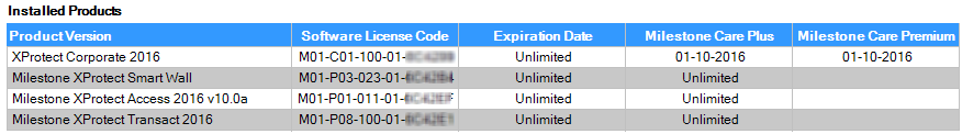

Installed Products
Lists the following information about all your installed base licenses for Система управления видео XProtect and add-on products that share the same software license file:
- Products and versions
- The products' software license code (SLC)
- The expiration date of your SLC. Typically, unlimited
- The expiration date of your Milestone Care Plus subscription
- The expiration date of your Milestone Care Premium subscription
Some licenses, such as XProtect Essential+, are installed with the automatic license activation enabled, and it is not possible to disable this setting.

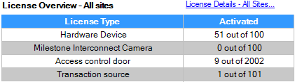

License Overview - All sites
Lists the number of activated hardware device licenses or other licenses in your software license file and the total number of available licenses on your system. Here you can easily see if you can still grow your system without purchasing additional licenses.
For a detailed overview of the status of your licenses activated on other sites, click the License Details - All sites link. See the License Details - Current site section below for the available information.
If you have licenses for add-on products, you can see additional details about these under the add-on product specific nodes in the Site Navigation Pane.

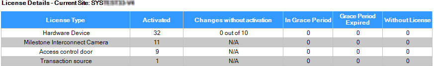

License Details - Current Site
The Activated column lists the number of activated hardware device licenses or other licenses on this site.
You can also see the number of used device changes without activation (see Device changes without activation (explained)) and how many you have available per year in the Changes without activation column.
If you have licenses that you have not yet activated and that therefore run in a grace period, these are listed in the In Grace Period column. The expiration date of the first license which expires, appears in red below the table.
If you forget to activate licenses before the grace period expires, they will stop sending video to the system. These licenses are shown in the Grace Period Expired column. For more information, see Activate licenses after grace period.
If you have used more licenses than you have available, these are listed in the Without License column and cannot be used in your system. For more information, see Get additional licenses.
If you have licenses in a grace period, with an expired grace period or without license, a message will pop up to remind you every time you log into your Management Client.
Hardware devices without licenses are identified by an exclamation mark in the Management Client. The exclamation mark is also used for other purposes. Place your mouse over the exclamation mark to see the purpose.
