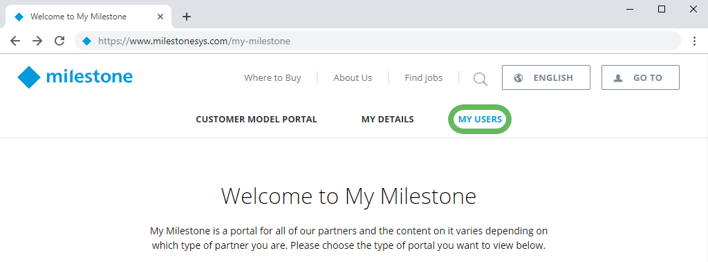

  1. Log in to My Milestone (https://www.milestonesys.com/my-milestone/).
  2. Select My Users in the main menu.

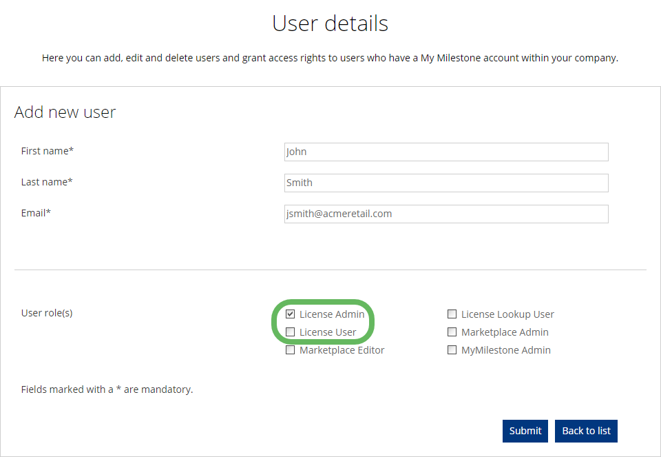

  3. Select Add New User in the bottom-right of the User administration page.
  4. In the User details page, enter the required contact information, select the appropriate user role, then select Submit.

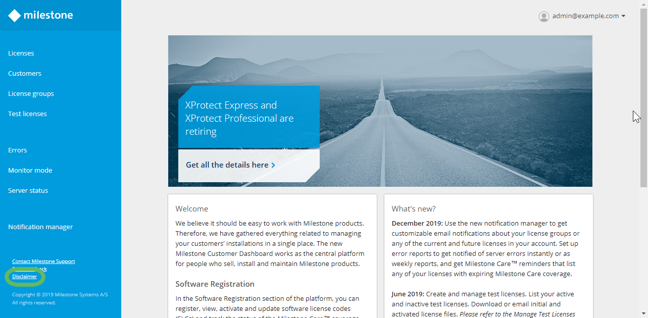

  1. Log in to Milestone Customer Dashboard (https://online.milestonesys.com/).

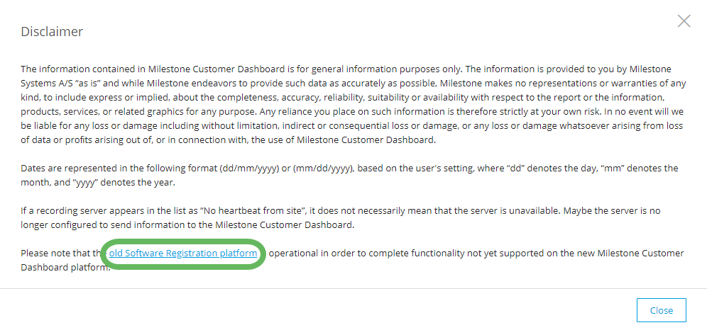

  2. Select Disclaimer in the bottom-left corner of the menu.
  3. In the Disclaimer dialog box, select the link to go to the legacy software registration platform.

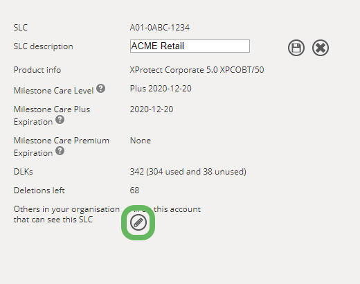

  4. On the Software Registration tab, in the Active SLCs list, select the license.
  5. Select the icon next to Others in your organization that can see this SLC.

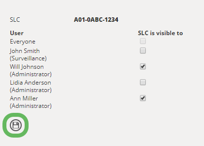

  6. In the SLC visibility dialog box, select the SLC is visible to check box next to the users you would like to manage the license, then select the save icon.
