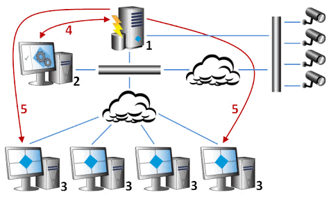

Legend:
  1. Surveillance system
  2. Management Client
  3. XProtect Smart Client
  4. Alarm configuration
  5. Alarm data flow
